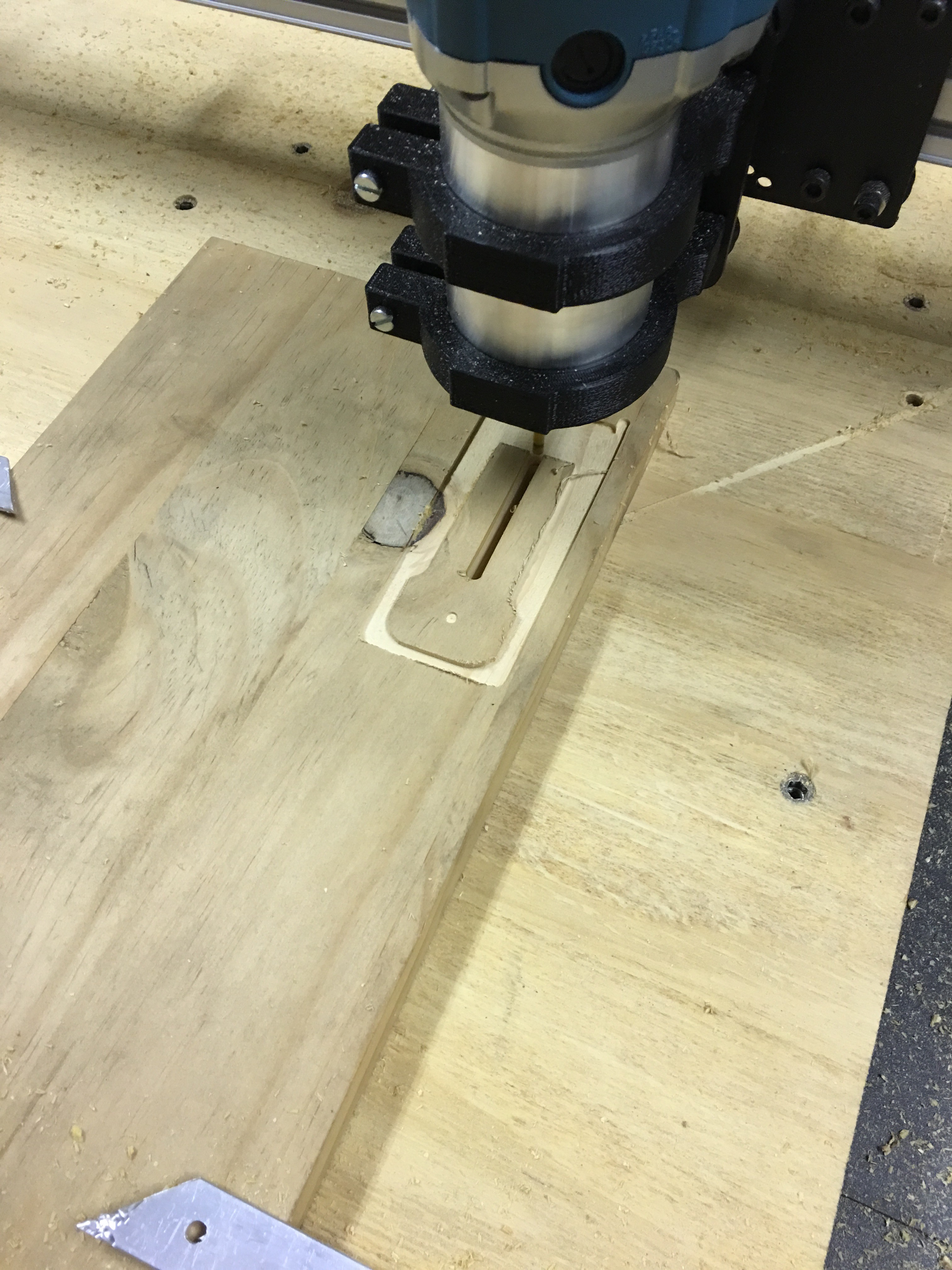

Woodserts are in. Next project is to make a few work clamps.
Clamps drawn and being cut.
I guess I should consider cutting the router mounts out of something stronger than the 3d printed pla they are currently. But I have to say I’m totally smitten with this machine.
