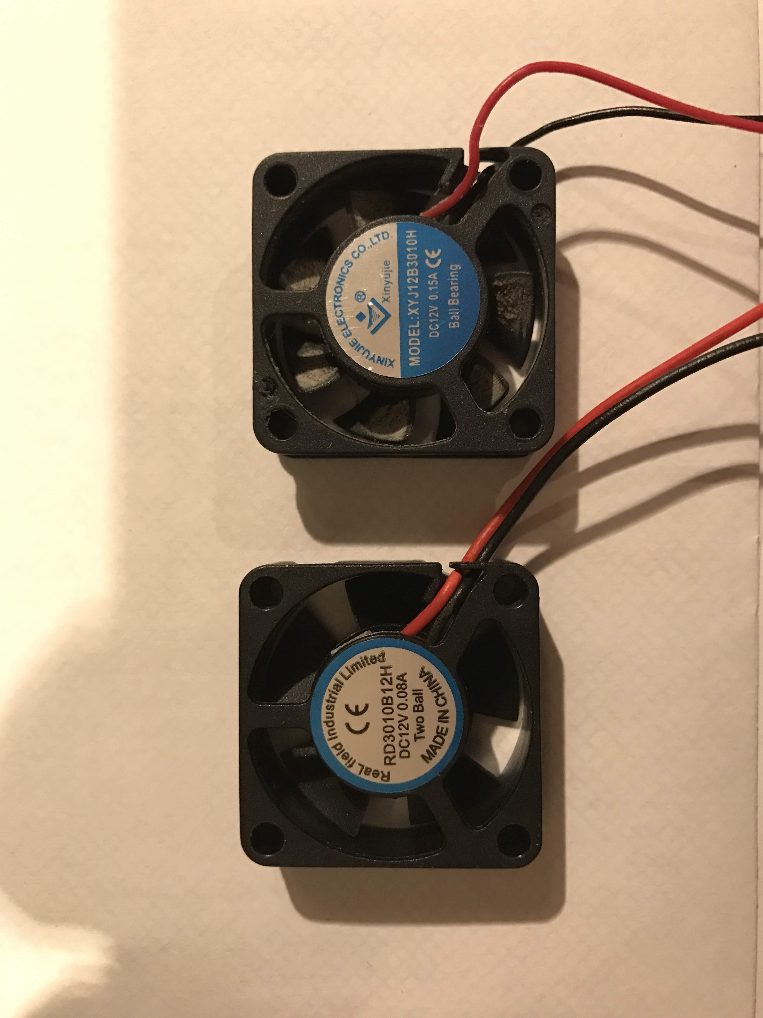

What’s the secret to obtaining quiet fans? On top you see the 7 bladed e3d fan. It’s quiet. Beneath is “some generic fan I got off AliExpress”…it sounds like a wailing banshee. It can’t just be the two extra blades, can it? And recently recommendations on how to obtain quality blowage?

My point wasn’t that you could go larger to make it quieter, but that there was a clear quality/sound difference between two different makers. I’ve also found some fans do NOT like to be throttled back, making a nasty whine when you do so.
Yeah bad quality ones have similarly bad quality bronze bushings for the motor. Good quality 3010 fans use bearings not bushings. The problem is at 24V the selection is more limited than 12v.
My rule of thumb is wider blade angle more airflow, more blades (less space in between blades) more pressure. Just get some brand name industrial fans so you can read their datasheets. like sunnon kde series. sunon maglev kde1204pkv2 is the best for quietness and has 8cfm but its a 40x40x10mm. Also avoid ball bearing chinese fans, most of them suck.

Number of blades is a factor in noise but there’s other factors. A cheap 7 blade 30x10 fan won’t necessarily be any different than a cheap 5 blade 30x10 fan. I like to go with a larger fan if I can, as quiet one as possible that still exceeds the static pressure and rated flow as the fan being replaced.
Fan noise is mostly a matter of RPM. Slower fans are quieter. A slower fan needs more blades at a steeper pitch and more current to push the same air.
Other stuff like bearing and electronics quality also matters, but RPM is the biggest one.

There is a lot of engineering that goes into designing a quiet fan, as the ballance of airflow and noise involves a lot more than just the speed and number of blades. E3d is willing to expend the effort, Chinese clone companies aren’t.
@William_Eades it’s not like E3D is designing their own fans. They just pick one from a catalog. You can get on Digikey or other major parts vendor and the dB level is listed for most of the fans.
Whether they design it themselves or outsource it, they choose to use a well designed unit which will cost you a little more.
AFAIK there are 3 methods to mount the blade onto the base. There are sleeve-bearings, fluid-bearing and ball-bearings (or even better double-ball-bearings). The cheap and often bought “chinese”-ones have the cheap sleeve bearing. While the fluid-bearing ones are theoretically the best ones in the list, they actually aren’t because of our use-case. The fan is constantly moved around very rough (think about infill movement) so ball-bearing types are the best to use for us. But they are more expensive.
Bearings play a large part but there are also blade profile, cavitation, intake and exhaust area/restriction, RPM and venturi effect calculations that must be made and balanced to produce the most effecient fan for the money.
