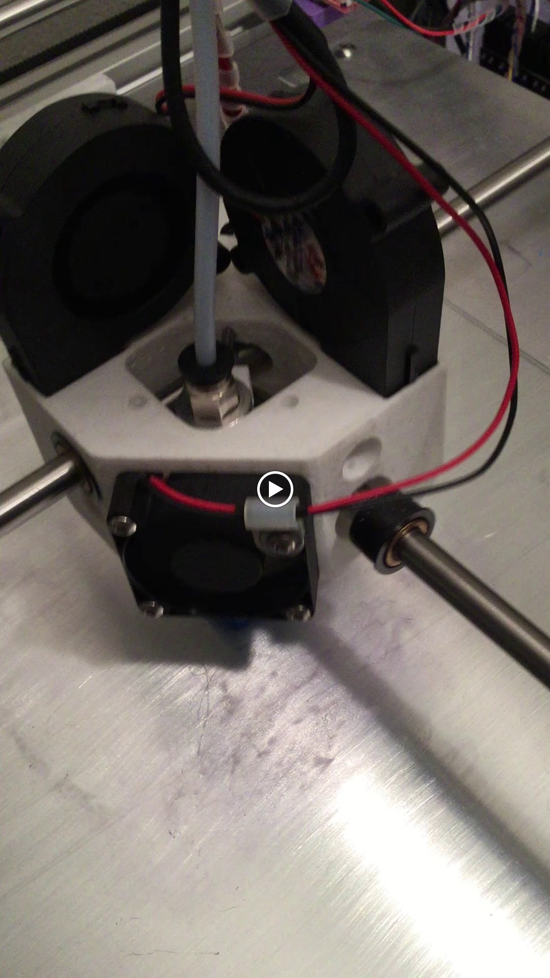

Bushing fell out mid-calibration cube - I thought the holes tight enough, they were light press fit… But I guess that’s not enough.
Do you all glue in your bushings?

Same happened to mines. Put 2 dots of glue on each and you’ll be fine.
I do my carriage in abs, then soften the hole (which on my model is slightly undersized for this purpose) with acetone on a Qtip. I keep applying acetone on the Qtip until it softens enough to be pressed in. This helps glue it in, and also if you do both sides at once with the rod through the middle of the bushings while you do it, it makes for a perfect alignment.
@Eclsnowman I’m in the middle of my build currently and found that when “gluing in/ acetone setting” the bushing into your components doing both sides at once with a rod thru them to setup the alignment made a huge difference in overall performance and reduction in efforts to move the components later. This is a great Tip for anyone looking to start their build. Doing them without a rod to align them allows for misalignment that you end up fighting afterwards.

First off, thanks to everyone! I’m more than pleased with my build, and there are more improvements to make.
Second, a few drops of superglue got be back up.
Third, my initial prints were in PLA so I couldn’t use the acetone trick, but I’m printing replacements in ABS on the new system now.
