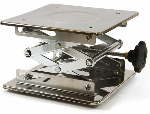

so for the lightobject upgrade head with air assist you really need a up/down table for your material ?
@Bart_Libert ​ You just need to be able to adjust the bed height. I’ve got a set of spacers that I can pop under my main bed tray (I pulled the stock bed out) based on the normal sizes of things I do - 1/8", 1/4", 1/2" (engrave only). I do have a small “lab jack” I’ll put in sometime so I can just twist a knob to set the height.

I use a lab jack too they are cheap and great
@3D_Laser ​ link?
@Ariel_Yahni_UniKpty ​ here’s the one I got: https://www.amazon.com/gp/product/B019QFND1C/ref=oh_aui_search_detailpage?ie=UTF8&psc=1
I got an eight inch one here though it was a bit to big and I had to take out half of the jack
I looked at a bigger one but just screwed a piece of plate steel on it - not like ply & acrylic sheets are very heavy. Use super magnets to hold it to the bottom of the k40.
