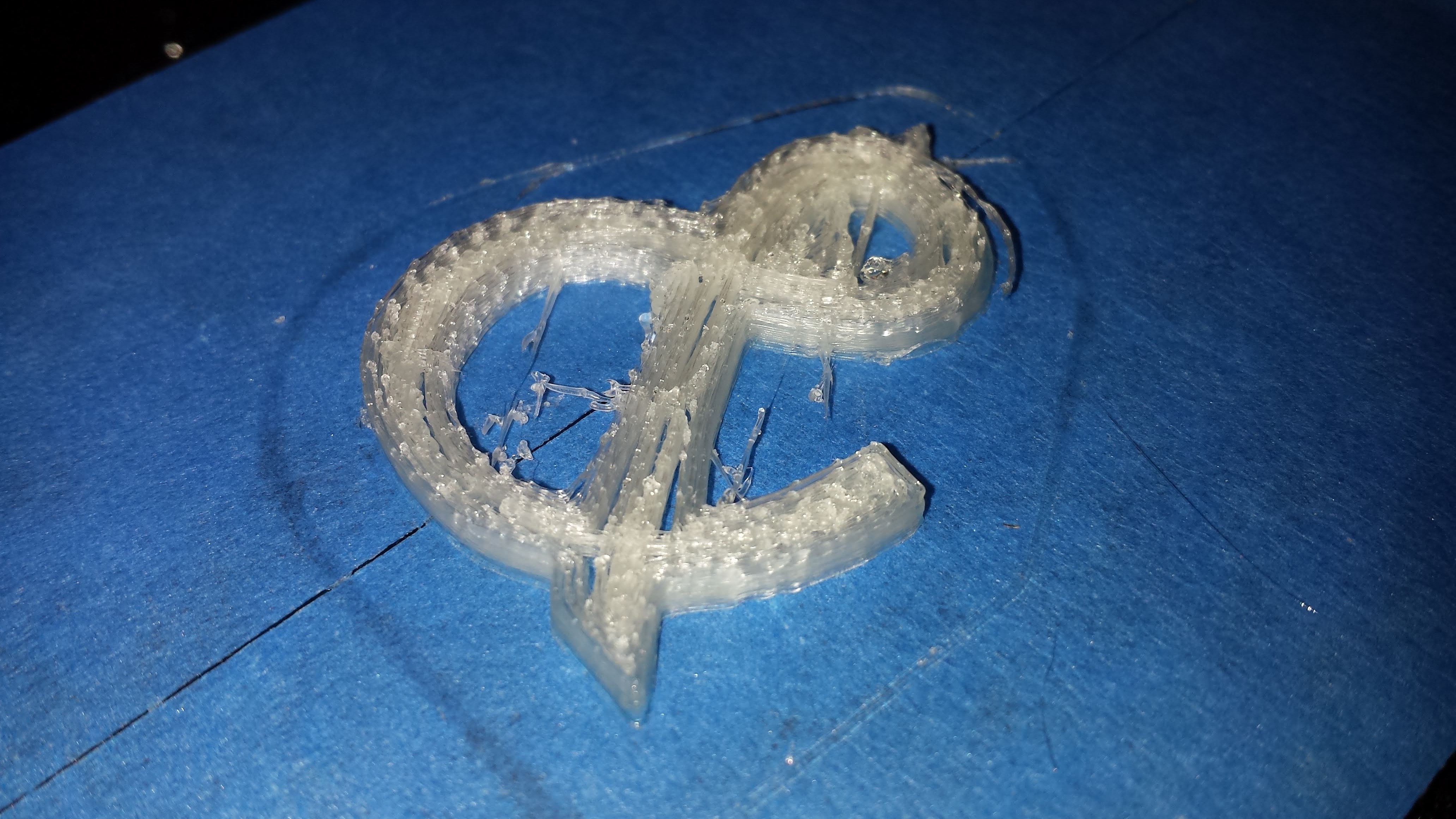

When 100% infil isn't 100%.  So, lookie here and say "yeah,
When 100% infil isn’t 100%.
So, lookie here and say “yeah, you need to double your stitching, or widenize your influx”
Or am I just supposed to expect gaps between the edges and insides of my prints?
Looks like the same problem I had. Turned out to be the filament extruder temsion. Measure 10mm of filament and extrude 10mm see if it matches, adjust your tension accordingly.
So when you extrude 10mm of filament, it’s 10mm unextruded filament? Not 10mm of the .35mm-ish extruded filament? (Things get a little unclear in Pronterface)
10 mms of source, yes.
Yes. Make sure the filament is pulled whatever distance you specify.
Yes mike, it’s 10mm of unextruded filament. As in the circumference of the hobbed bolt should rotate 10mm.

I definitely understand the principle of testing extrusion with the hot end off. But now that I’ve spend my bot up I’ve been calibrating with the hot end on at print speed through repetier flow slider. I print a very large, very flat surface and adjust until I get the proper extrusion. That way if there is any slippage I am adjusting for it. Now my top in fill as smooth as ever.

Man this is seriously frustrating. I’ve got the e-steps calibrated. The filament being laid down is still thinner than slicer wants (IMHO) to be 100% infill. laying down 4 thin layers to check flow has the extruder plugging about 80% of the way through the print.
