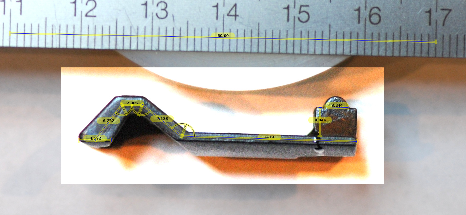

When creating models (replacement parts or parts that interact with real world objects), I find myself measuring a lot parameters in the ‘real world’.
While calipers are still the most valuable tool for that, I simplified a lot of it by simply taking a picture of the object with a ruler in the same focal plane; then wrote a little tool that allows to draw simple lines and use that ruler to declare a known reference length - then all lines can be measured accurately enough for many uses. Also: angles between lines. Very simple, but pretty useful.
This tool is in JavaScript, so you can use it right in the browser (there is a link in the README.md)
Pull requests welcome.

It is pretty simple to mark a trapezoid and use the information information to measure things in different distances @Stephen_Hall ; however keep in mind that this still forces the user the estimate in which distances (z) a particular object is when measuring its (x/y) parameters. Since in practice, when taking a picture of the object for measurement purposes, you have a good control to keep the lines straight (often less possible in the crime scene example :slight_smile: )
Figuring out the parameters of a circle with 3 points on the circumference is a TODO.
Right now, the picture is just a reference for the human drawer, the tool doesn’t infer anything from it, @Liam_Jackson . I was considering that (graph paper, or paper with special markers), but given that that detection would easily be dominating the needed code (in particular in JavaScript), I was going with the simpler route for now :slight_smile:

Cool :slight_smile: Could you add the option to split the line into its x and y values? missing/deleted image from Google+
Regarding splitting line into (x/y) compoents, @enhydra , I’ve now implemented something that is probably useful for you.
It is not as simple as adding these lines for everything. The following questions come to mind:
  • Should this be for every line ? This might look a bit messy after a few lines.
  • In your particular case, you have a generated plan that has x/y exactly aligned to the axis of the picture. In a photography case, the image might be a bit rotated, so we might need to request the user what the 0-degree horizon would be, otherwise the dx/dy lines won’t make much sense.
So the compromise: there is now a checkbox at the top that allows you to switch on seeing dx/dy values. While drawing a line, it shows the square bracket, on final lines it just puts the dx/dy in the label to avoid too much clutter. Please try it out.
