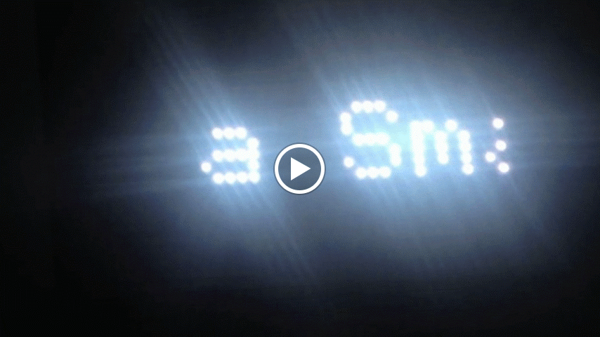

When I get insomnia, I get silly and punchy. But hey, SmartMatrix wrapped in a CLEDController. So now you can do things like:
setup() { FastLED.addLeds(leds, NUM_LEDS); }
Also, while all the smart matrix stuff is wrapped up in the controller, there is a pointer to the matrix object exposed, so you can do things like:
loop() {
fill_noise(…);
pSmartMatrix->drawLine(0,0,32,32,CRGB(CHSV(hue++,255,255)));
LEDS.show();
Or even show off scrolling text.
Anyway - there’s a bunch of code cleanup that I need to do, as well as making some final decisions about what level of changes I want to push back to the SmartMatrix library to make this support smoother/easier.
For now, though, i’m going to try sleeping. Hopefully, the video will be ready by the time I wake back up …
DEMOSCENE FTW!
