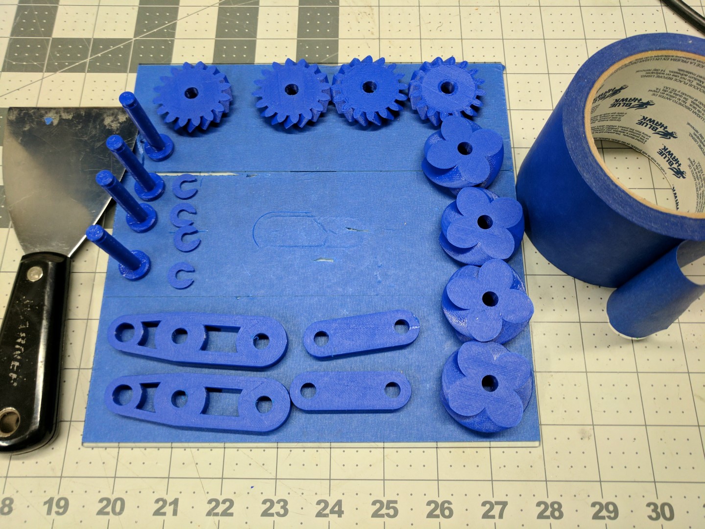

When I read about people using painters tape to hold down their parts onto glass(show in the picture) and aluminum beds, I never see anything other than 3M products. So here’s my 2 bits on Blue Hawk:
I’ve been using it for 3 months now with only a few issues that I’m sure other tapes have as well.
I picked the 2.88" Blue Hawk tape up from Lowes for $8.48, about 10 lbs of material ago. I’m not even half way through the roll. In the picture, you can see that the tape is damaged a little because I was having a tough time getting some of the prints off of it, so lifting parts is not usually an issue. Also, all of those parts (in the photo) were printed one-by-one in the middle of the bed. The parts are flipped upside down so you can see the first layer prints. A lot of prints can be done on one piece of tape.
The problems I have had are trying to get a large flat bottom part off of the tape. If my base layer is set too low, I have to damage a little bit of the print just to grab a corner to get it started. Once it’s started, it comes right off. Sometimes the tape will bubble up in between a part and I will have to use my putty knife to smear it back down for the next print. Speaking of knife; I recommend that you use a putty knife and sharpen the end of it to almost a point. Be careful, because I’ve had a few close calls.
Hope this helps someone.

@EL_TALLER_DE_NEURUS The painters tape is stuck to a piece of glass. The ‘gray ribbon’ is a mat to protect my table.
