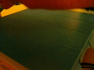

When I woke up this morning, and checked on the print that I had done, I found a huge stringy mess. The other prints were fine, but one print didn’t make it.
Played the timelapse video, and first thought that it all looked fine, there wasn’t anything bad that seemed to happen. Then, disaster struck.
It’s usually hard to see, but there are always forces on the parts being printed as new layers are extruded. That one part got tall enough that the lever arm became long enough for those forces to be stronger than the adhesion to the tape.
I’m sure a raft or brim on the tall part that broke off will make it work the next time.

Ha! Submarine wing, a project that involves taking apart an RC plane.
It looks to me like a printrbot keychain and the locking arm for the extruder. I can’t figure out what the tallest part that came off the build plate is.
Oh, I thought that is what you meant. Correct on the first two, the tall one is a submarine wing.
