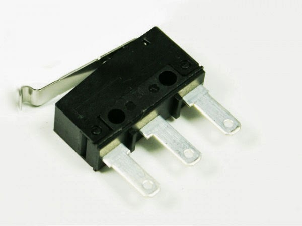

On X and Y, you don’t really need repeatable endstops. For Z you do, but microswitches (preferably without the lever) seem to fall into the “good enough” category.

@Brad_Hopper we tested the repeatability of the Z endstop on an Ultimaker. It had a slight variation of 2 micron. If you only accounted for the switch.
