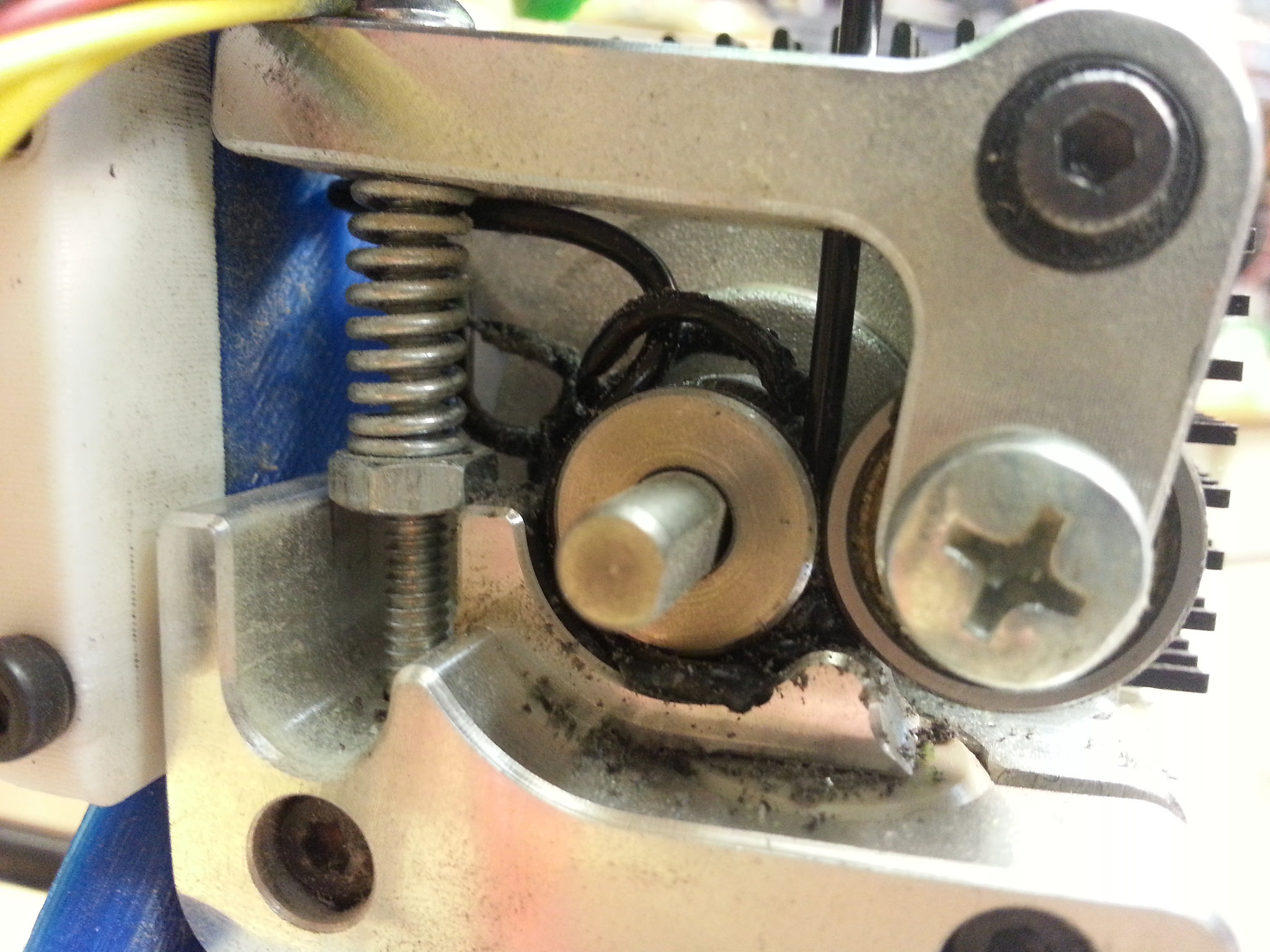

I forgot to turn on a supplementary cooling fan. Its job is to cool the top half of the Ubis and extruder assembly.
Came down to find the PLA packed into the hot end and wrapped around the extruder like I’ve never seen before.
Took a while to clean that mess up…

Looks like the tension nut on the idler is too high, try loosening it. That could account for the hot motor. Go as loose as you can but as tight as you need. That tight setting could be deforming the plastic and making it hard to shove the square plastic through the round hole.

On other gears I’d run into trouble squeezing filament too tightly that it compresses filament, increasing drag down the guide.
Just talked to Carl and he said heater and thermistor don’t degrade. They can give out completely - I’ve seen it a handful of times. But no slow spiral. The barrel can get charred w plastic residue if filament sits in there while hot and it increases drag. A “cold pull”, preferably w nylon, will clean it out. If you run s lot of carbon fiber, the passage in the barrel can get scored or eroded. But it takes a while. The hole in the tip can grow when eroded w carbon fiber but it has different symptoms. The print accuracy will degrade and look like underextrusion.

The heater and thermistor don’t degrade, but the PTFE or PEEK in the hotend can.
Also stepper motors don’t get hotter under increased load, they actually get cooler. (assuming that the stepper driver’s Vref is not changed) Stepper motors are constant power devices, any energy that doesn’t get converted into mechanical work is becomes heat.
Agreed. I was just wondering if they turned up the pot to compensate for more resistance on the filament. Once tensioning is good, try the 60% setting on the pots and see how the motor feels. Not sure if you turned up the pot.
