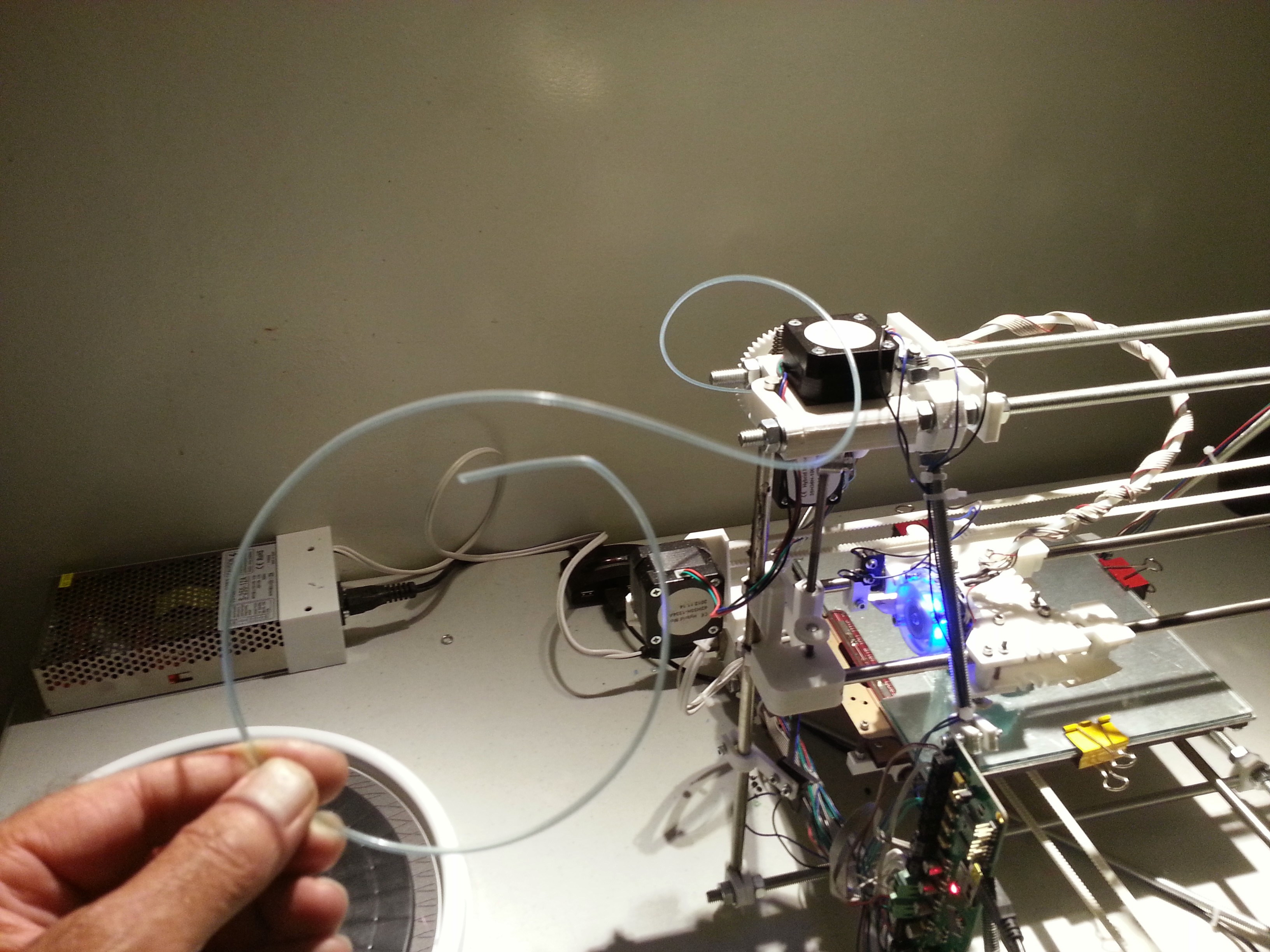

Yup. I had a spool of PLA that I unfortunately tried unwinding from an existing spool onto one of those yellow extension cord spools… This of course left the outside diameter of filament on the inside of the new spool, and the inside diameter on the outside. After a month or two I looked inside the spool and saw maybe like 40-50 clean breaks in the plastic filament… As the plastic unwound from the spool, more small sections of plastic fell. Some of them went around the spool a few times before breaking, so I had a bunch of roughly meter or two long pieces of plastic that I didn’t want to waste. It was awful. :slight_smile: I’ll look for pics.
Found a pic… Here was a view inside the side of the spool… Not good. http://www.keegan.org/jeff/homemovies/miscimages/misc-2013/IMG_8120.JPG
Ouch! Toast.
