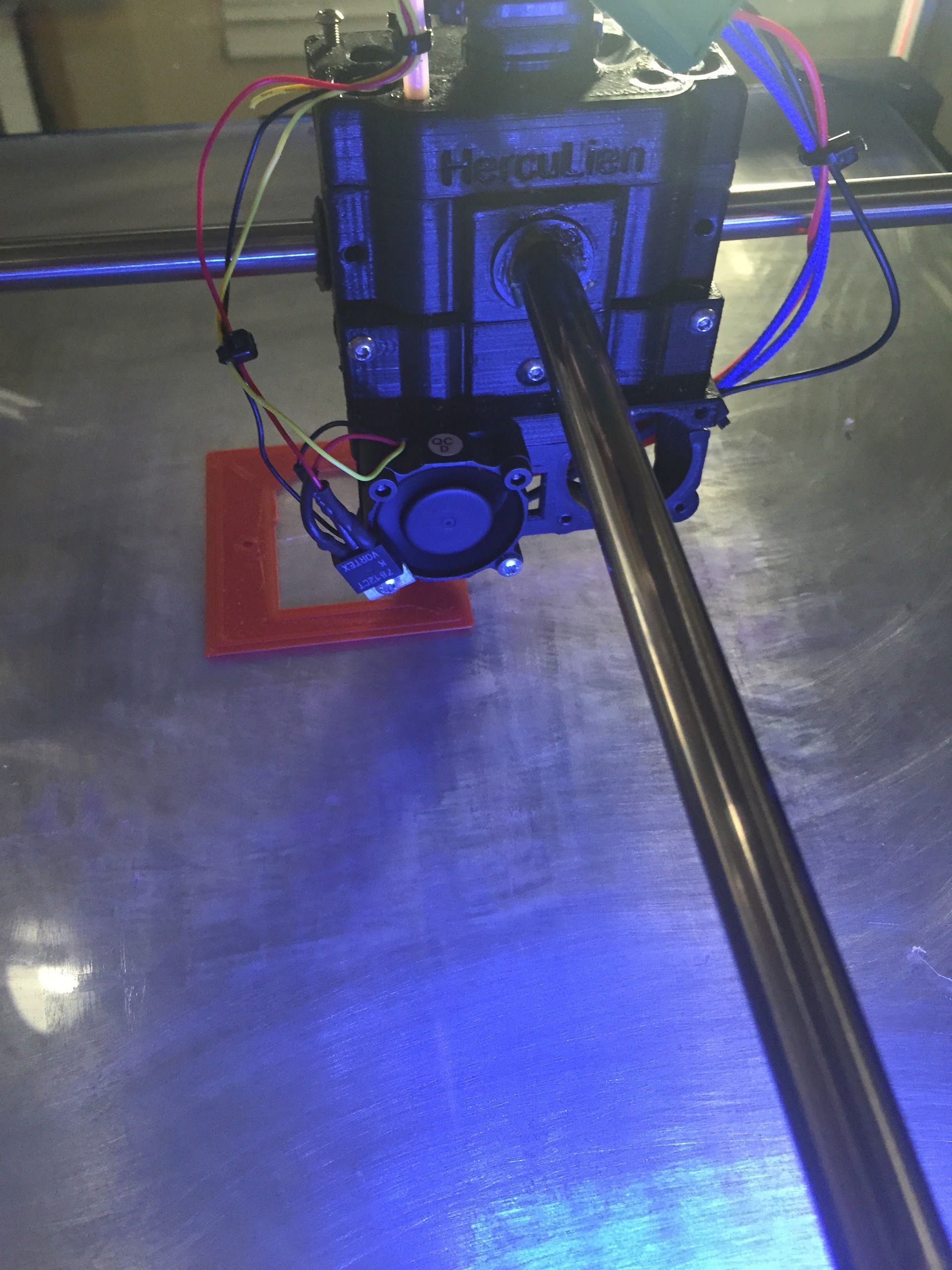

When your local electronics store only carries 12v fans…
I’ve done the very same thing, but for a much larger fan pointed at my driver ics. I’ve got a 7812 cable tied into the path of the fan.
