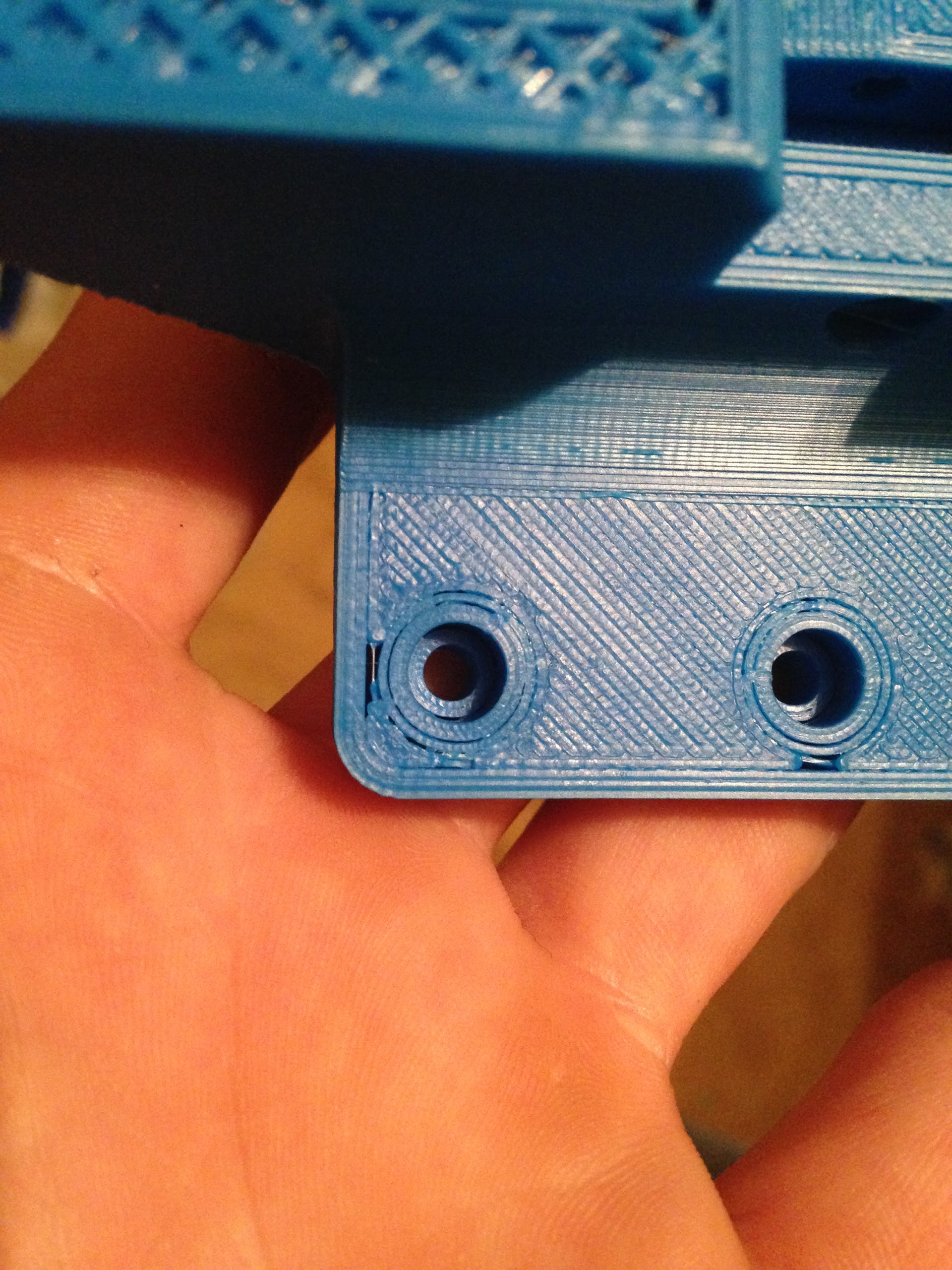

Where in slicer can this issue be fixed?
I think this might be a perfect instance where http://richrap.blogspot.com/2015/01/slic3r-advanced-perimeter-tuning-3d.html?m=1 would come in handy but for solid or top solid infill
Ty sir
It looks like reducing the number of loops might help
2 walls
8% infill
0.1 layers,10 off top & bottom
If PLA 210dg
get Simplify3D
Tick the “Detect thin Walls” option

I won’t get simplify until I can do a trial or demo.
@Zane_Mitchell , completely worth buying imho.
Plus one to @ThantiK ​ for the link to the perimeter tuning article. That was an educational read, for me.

May not want to hear this… but try Cura? It does not have all the features of Slic3r, but I prefer it to Slic3r when you are doing something that it is capable of. It doesn’t do think walls (AFAIK), and only rectilinear infill…
