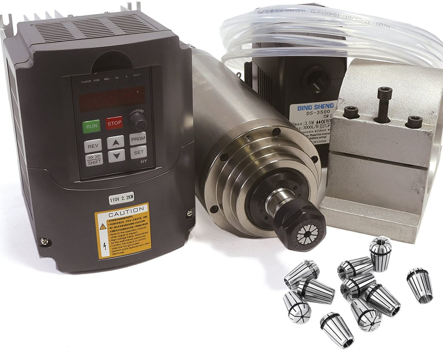

@Chuck_Comito I forgot are you running a VFD on your spindle?
@donkjr , I honestly don’t know what it is. It’s a 0-10vdc controlled motor controller. It outputs 0-100vdc to the motor from the 0-10vdc signal. I am however looking at this: 2.2KW Water Cooled Spindle Motor ER20 110V/AC Kit & 2.2kw 110V Inverter VFD 3HP & 80mm Clamp Mount & 75W Water Pump 110V with 6M Pipe & 14pcs / Set ER20 Collet for CNC Router Engraving Milling Machine https://www.amazon.com/dp/B0756WNP1J/ref=cm_sw_r_cp_apa_i_ijG.AbS7SZHY2
What’s your thoughts on It? I don’t want to spend good money after bad.
@Chuck_Comito the reason that I asked if you were running a vfd was because there are ways to brake the motor on those controllers but I have never done it.

I have looked at VFD multiple times but do not want to have to add coolant or put out another $400 and another controller. I decided to cross that bridge if I need more power which so far doesn’t seem to be the case. I also may consider using a dewalt router and manually speed control.
@Chuck_Comito one additional thing. If this is the one I am thinking of the 2.2KW is a beast (24lbs) and I am not sure my stepper can push it like I need.
Those are valid things to consider @donkjr … I really need to get a proper workshop so noise isn’t a factor. Otherwise I’d also be running a router. I’ll have to consider the weight ad well. I have a pretty beefy setup but an addition 24 lbs is a lot!
