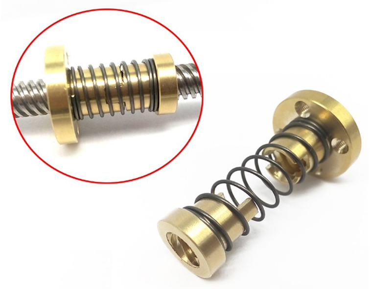

My printer is exhibiting Z-axis banding and I’m looking into anti-backlash nuts to eliminate it. However, I don’t know which one would be better, one of the brass nut + spring solutions or the delrin anti-backlash nut on Openbuilds.

They both work on the same basic preload principle, but the brass one will self adjust for wear over time and the delrin one allow for adjustable amounts of preload (you could adjust the preload on the brass nut too, but you’d have to change out the spring each time).
Either choice should give you the same effective anti-backlash effect, so I’d go with the one you’ve got mounting for already.

I’ve used the brass one. The oil-impregnated brass are nice, but plain brass get really noisy w/o grease or frequent oil. We use delrin that is slightly under-tapped if that makes sense.
