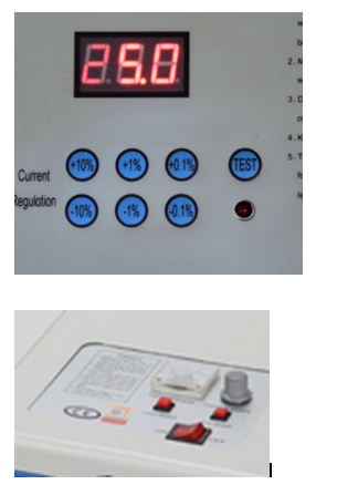

Which is better? Digital control panel or one with the analog dial meter? Is there anything I should look out for when buying one of these machines. I know (or think I know) what I’m getting into, but before I pull the trigger and order one, I would like to know which one is better? Both are pretty close to the same price. Is the digital one a newer model or newer board?
I agree the digital board looks more modern but I don’t think it is any easier to use. What made me decide to go for the digital option was I thought it would be more recent. I have added an analogue meter into the laser current circuit to check the current as the percentage numbers on the digital scale are uncalibrated and meaningless(70% is about 18mA). I think I was ?lucky? and got a system with Corel+Laserdraw software and not Moshidraw which nobody seems to have a good opinion of. Having said that I fully expect to replace all the control electronic before long but I haven’t found it absolutely necessary just yet. n.b. There are serial input terminals to the front panel controller board but I haven’t found out what they can be used for yet. I think they are to control the current setting but it may not be enabled in the front panel software - it isn’t in the laserdraw software either. hth David.
I do agree with @David_Richards_djrm , the digital version don’t bring much, more importantly you should go for the one with Corel+Laserdraw software . that will make it usable before a possible hardware update. With the update the control panel will go, so it doesn’t matter digital or not.
the latest "analogue"one (vue meter) have a pwm laser psu, witch is the important feature (see post 11/11/2014) for hardware update.
I couldn’t agree more with what has been said by @StephaneBUISSON and @David_Richards_djrm
Software and PWM PSU (plus for example the availability of limit switches, clear plexi or red plexi…etc) makes more towards leaning for one and not the other.
I’ll give you 3months before you venture into creating your own panel and possibly do some hardware upgrades as well
I agree with everyone who has commented. Personally, I purchased the one that was cheapest. This saved me some money for the upgrades I wanted to make. I bought the analog version with a Laserdraw mainboard and a PWM Power supply. I added a digital current meter that is more accurate than the one that comes on the digital display K40.(I dont believe that the digital display that comes with the K40 is a current meter,rather a percentage display) I bought a digital mA current meter from Lightobject.com for $9.00. It was nice to have a working Laser Cutter to make the panels and other parts before upgrading to a Ramps1.4/Marlin setup. Good Luck with your upcoming Purchase. I noticed that these units are selling on ebay now for around $350 here in the US.
