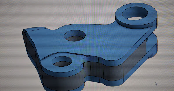

While my friend was visiting, a car backed up into his Ducati motorcycle breaking the mount that holds the clutch lever. A replacement part wasn’t going to be available for awhile, and without being able to shift he couldn’t ride home. Using Onshape and my 3D printer we solved the problem. And it totally worked! Being able to do this so easily just made us totally giddy and I had to share. :slight_smile: Here’s pictures:

@Dale_Dunn At some point we considered moving the bracket that holds the front brake level to the clutch side since it’s the identical part (just flipped over), but my friend decided he’d rather have front brake and give the 3d printed fix a try. Hehe, if he had gone clutchless his ride might have got pretty exciting when made it into downtown Los Angeles traffic! :stuck_out_tongue:

@Ken_Wagnitz Printing took about 65 minutes. Used .3mm layer height, and beefed it up with three perimeters and 70% honeycomb infill. Glued the parts together with 5 minute epoxy and then sanded it a bit. Had to use a round file to make the holes just a hair bigger for the bolts to slip in also.
