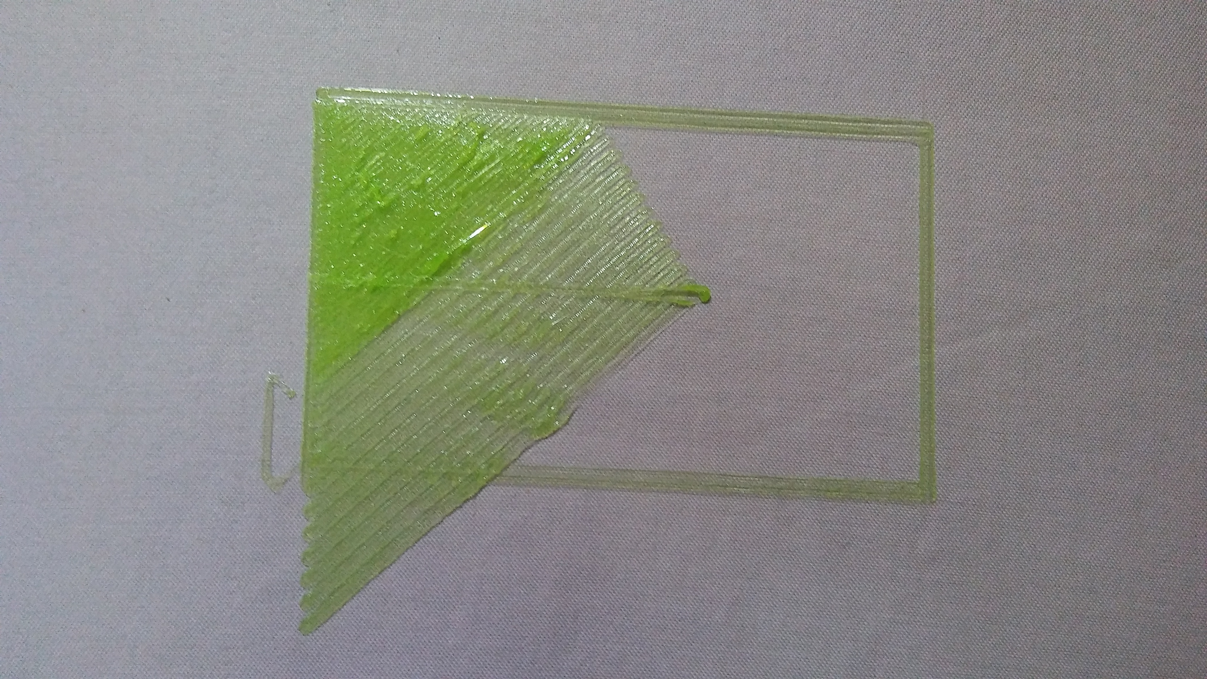

While trying to get my first print successfully printed off my my home made 3d-Printer I am facing this wierd issue in which the printer randomly bugs out and starts to print parrallel line .
I am attaching the print result i am getting i am guessing that it’s due to some firmware issue but not sure please help
Possibly corrupted gcode. What printer? Have you tried slicing the model again using different settings? Different slicer?
Sliced using different settings thrice but no different result , then restarted the host software and pc and the problem went away
@karan_sheth on what surface you print here?
Look like some Kind of fabric material?
@Karl_Schlacher The build surface i used was clear glass so i took photo on a fabric so that the photo is clear
@karan_sheth ahhh…I See - thank you. Looked like you print on the fabric - never tried this…maybe worth a try?
@Karl_Schlacher yep surely worth a try but The fabric should be heat resistant
Look at the preview, layer by layer. It may be the model.
@Keith_Applegarth Nope its not the model , the model is test print of hello world
Does it do that in the layer by layer preview?
