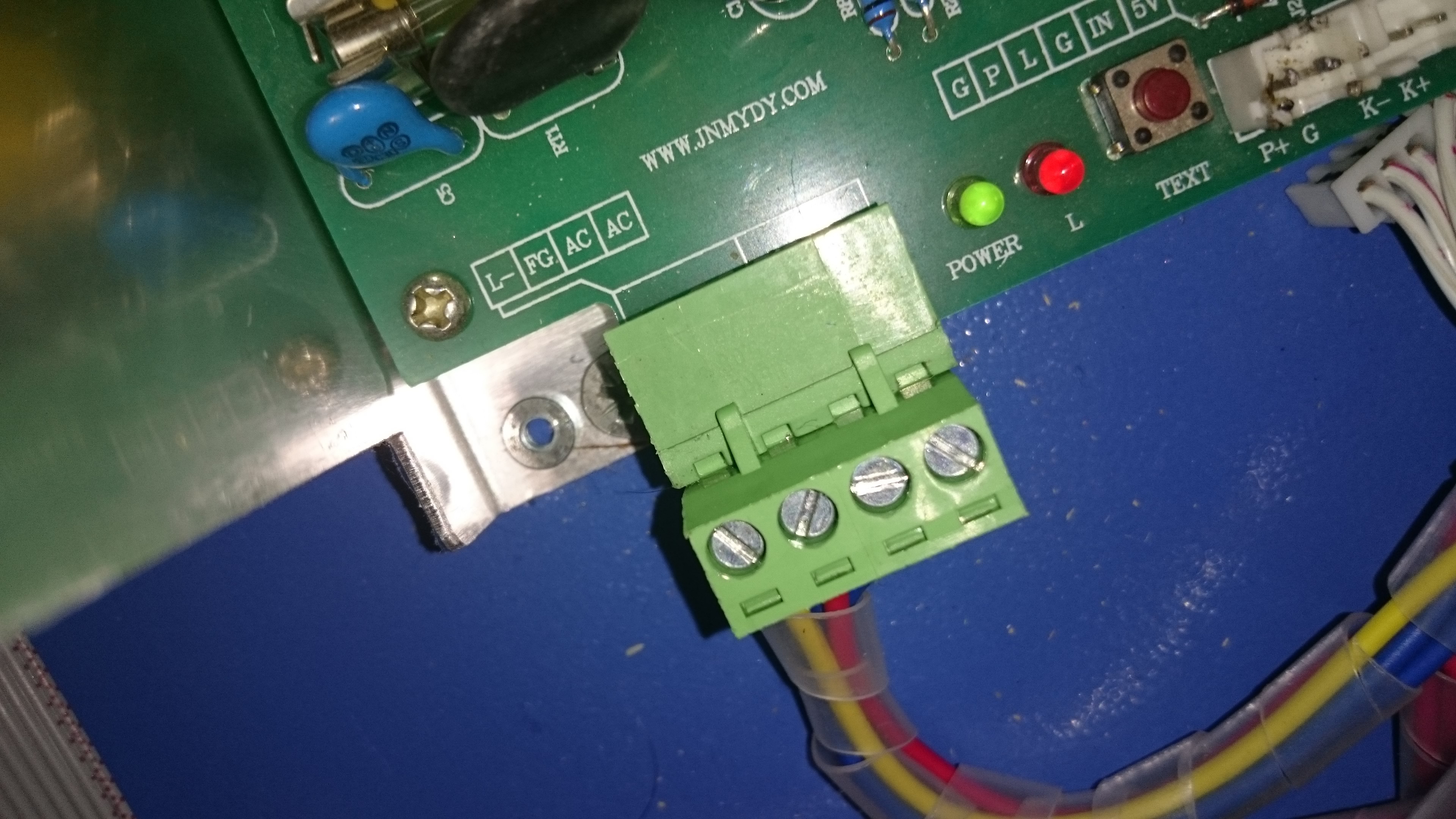

While working on K40 conversion, I have a question related to the Ampermeter connection.
While working on K40 conversion, I have a question related to the Ampermeter connection. I plan to connect it between the L- and the yellow wire (yellow wire originally goes from L- to the laser tube, so I will disconnect this wire from L- and connect Ampermeter between L- and wire).

The amp meter needs to be in series/in line with the circuit to work correctly. Just make sure that is still the case when you rewire.
This is exactly what I am going to do, connect the Ampermeter to L- and to the laser tube negative.
My stock K40 did not have Ampermeter installed, just a current regulator with three 7-segment displays allowing to maintain current percentage (+/-10, +/-1 and +/-0.1% of max laser power).
