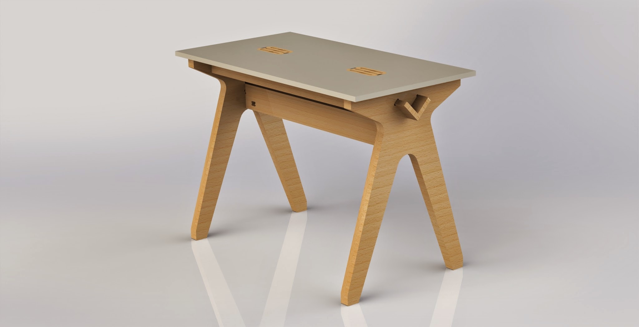

Whilst waiting for the delivery of my OX CNC parts I thought I would have a go at designing a desk for my workshop. My design is based on the Slim Desk by Lean which is available on OpenDesk.
I’ve modified the design to be shorter and narrower than the original though adequate for both my CNC machine and Laser Cutter.
I’m getting the design CNC’d by my brother-in-laws firm as a trial to see if I can deck out my Study with same concept.

The only downside I see to that is loss of storage underneath.

@Stephen_Creech Designed around no fixings, just glue and dowels! Almost like a giant jigsaw puzzle!

@Lav_Radis As requested: https://github.com/indieflow/CNC-Desk-1/tree/master/dwg%20Files would appreciate feedback on my first CNC based project :slight_smile:

That is very attractive.
FYI - Is the grain of legs running side to side? If so, the strength of the leg is compromised because it is most likely to break along the grain. Traditionally, woodworkers run the grain along the length of the leg.
@Bear_U thanks for the top tip though to be honest that is just the way the effect showed in the render! I will ensure when machining I take the grain into account :wink:
No worries… I’d hate to see such pretty work fail when you first use it! :slight_smile:
