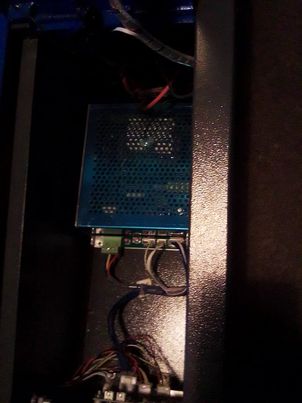

White block on red wire next to laser tube started to crackle and catch alight
It would be interesting to cross-section that block to see what’s inside if anything other than a splice.
How old is your machine?
soz reached my 20 posts for yesterday heres a picinside
thx for all your help bought the connecters installed up and running again thx
@donkjr, When @Jason_Harrison replaced his LPS recently he had one of these ceramic block splices. Apparently the wires were just twisted together inside the block and then sealed up with electrical tape where the wires go in.
Yea @donkjr there was nothing inside it other then the two wires. They were simply twisted together. The only “safety” it has is the block and a bunch of electrical tape. If I had the forethought I would have taken pictures.
I was just wondering if there was a ballast resistor in it, the old vintages had one in series with the HV.
Instead it’s just a crappy splice!
