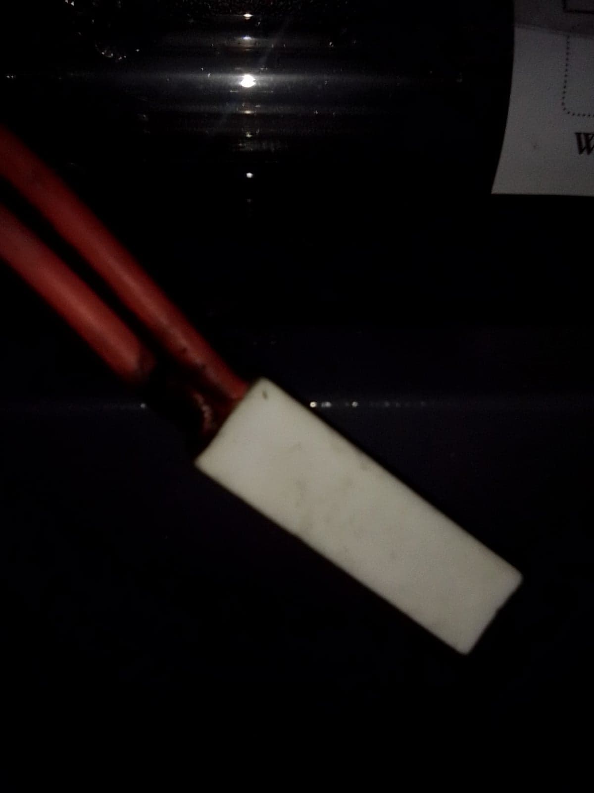

White block on red wire next to laser tube started to crackle and catch alight
hi everyone ive been using my k40 for just over a month with great results then i heard crackling coming from where the laser tube is situated powered down took a look inside and noticed the wire was starting to catch fire near the white ceramic block can i change this block and rewire the wires to a new one and if so what type of block am i after thx

Can you post pictures please? Different K40s look different, and pictures help avoid misinterpretation.
this is the wire thx
Yikes! Is that a spliced wire? I’ve never seen something like that in a K40 before.
dunno if its spliced as its going into some kind of ceramic block
So does one wire go to the power supply and the other wire go to the tube?
yh as far as i can see but the wire right next to the block was trying to catch alight so i switched off straight away
My guess is that you had a crack in the insulation on that HV wire and it was arching to ground on the case probably. @donkjr is the HV guru here and we can see what he says. If that’s the case you will probably have to cut the ceramic block off and cut and strip back to good insulation. You can then resplice the wires.

cheers sounds like this is happening

Are there any markings on that white block?

there one red wire in the casing where the laser tube is its a red wire as shown in the picture with a white ceramic block on it
