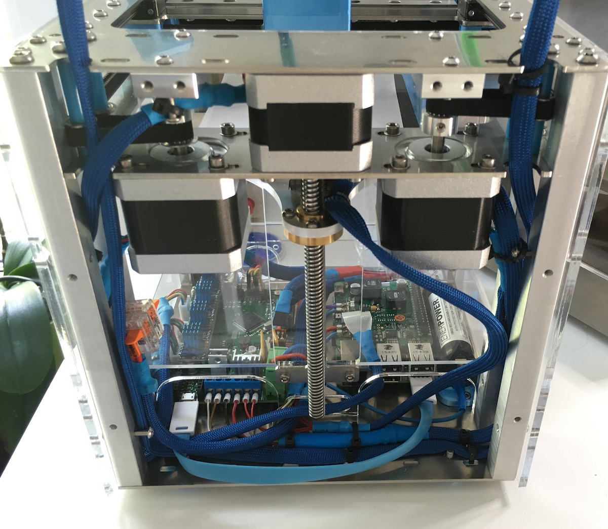

Who else is putting effort into his electronics-compartment?
Who else is putting effort into his electronics-compartment? Show me your cable-porn! :smiley:

+Peter van der Walt That is an UPS. It is the PiUPS+, so the UPS and the Pi can be sourced by 24V directly. Further, it is configured in a way, that I can just cut the power and the Pi is then automatically shutting down. Additional, it is going to run the hotendfan for about 75 seconds, if a powerloss occured while printing.

is a larger and thus more quiet fan possible?
I’m more curious to find out more about that printer! Looks great what is it?
@Marcus_Wolschon Nope. That’s the maximum size to fit. In the normal version (speak: not transparent and aluminium enclosure) the drivers are attached to the sidewall and are cooled passive. The acrylic-version is just for show purpose. I am talking about this printer at fabcon, germany, in june and this version is to show the inner parts…
@Brad_Hill If you don’t know the DICE yet, just visit http://www.well-engineered.net, there is much more information about it :slight_smile:
