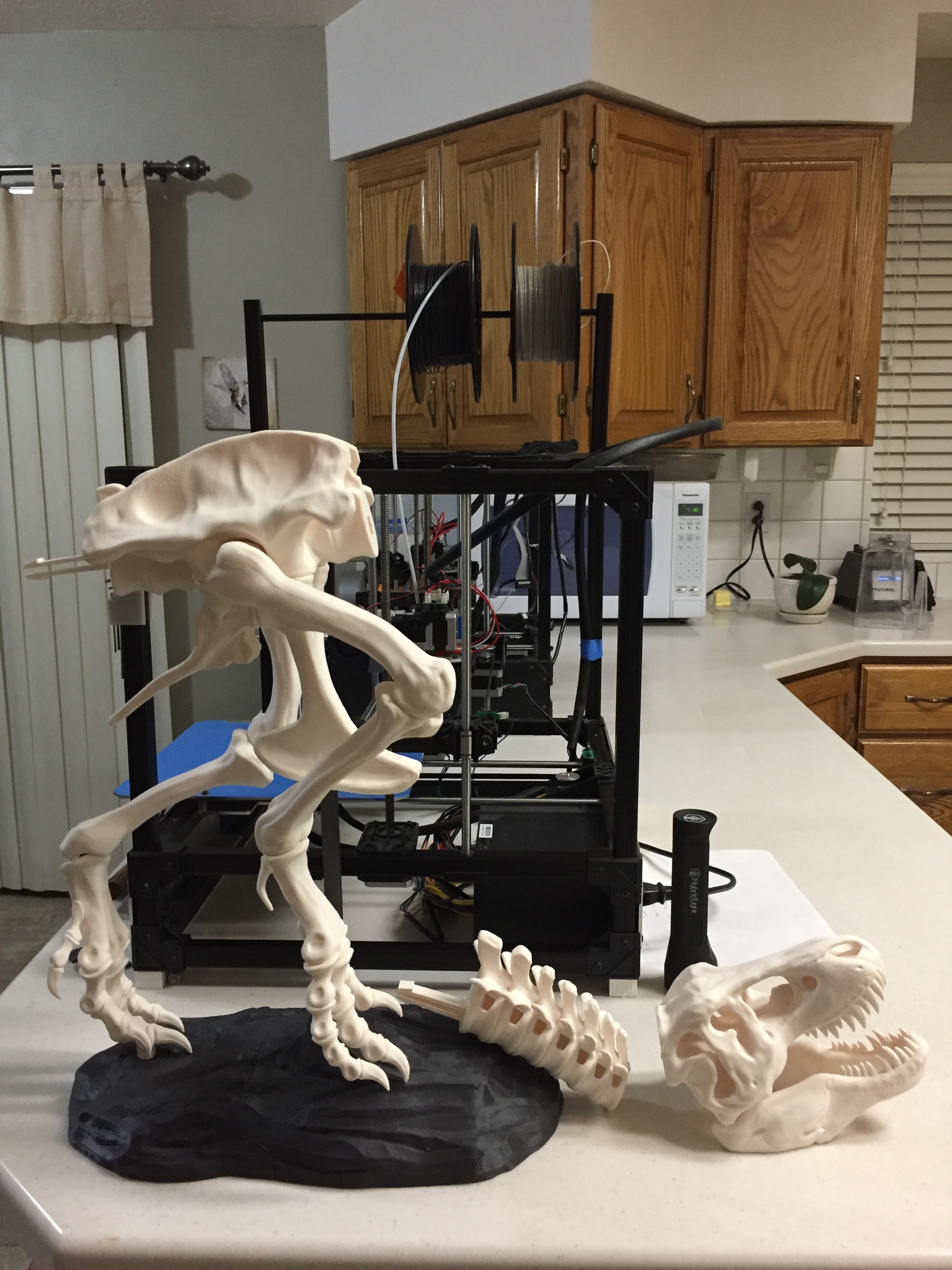

313+ hours and 1.6 Kg of filament so far. About 250 - 300 hours to go…
Here are the specs for those that wanted them.
2X scale for a 1:10 scale or 4 foot long display. 18" tall
Bone White PLA filament from Vortex 3Dp (Marble White)
Gunmetal PLA filament from Vortex 3Dp
Thermally calibrated the filament
Layers 0.1mm (0.2mm first layer)
24% infill
Printed on upgraded Rigidbot 2’s (RB2, RB2-XL) and Reliabuild 3D (RB3, RBB3-XL) printers. Home built from kits.
What you see is what was printed. No post work other than removal of a few stray strings between small area details. The support beam was printed immediately after the front of the base was removed from the printer. Really easy to remove the base using a 3/4" chisel as a pry. No scraping or pounding. Nice and gentle. Popped right off. No bed level adjustment required for the following prints. The base pieces fit together perfectly.
