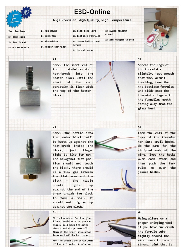

Hey guys, I just trawled through my order tracking system for your orders, and they are ALL in the post right now.
The updated V5 assembly manual is up now too, so do check that out:
I hope the assorted postal services get you your stuff pronto!
