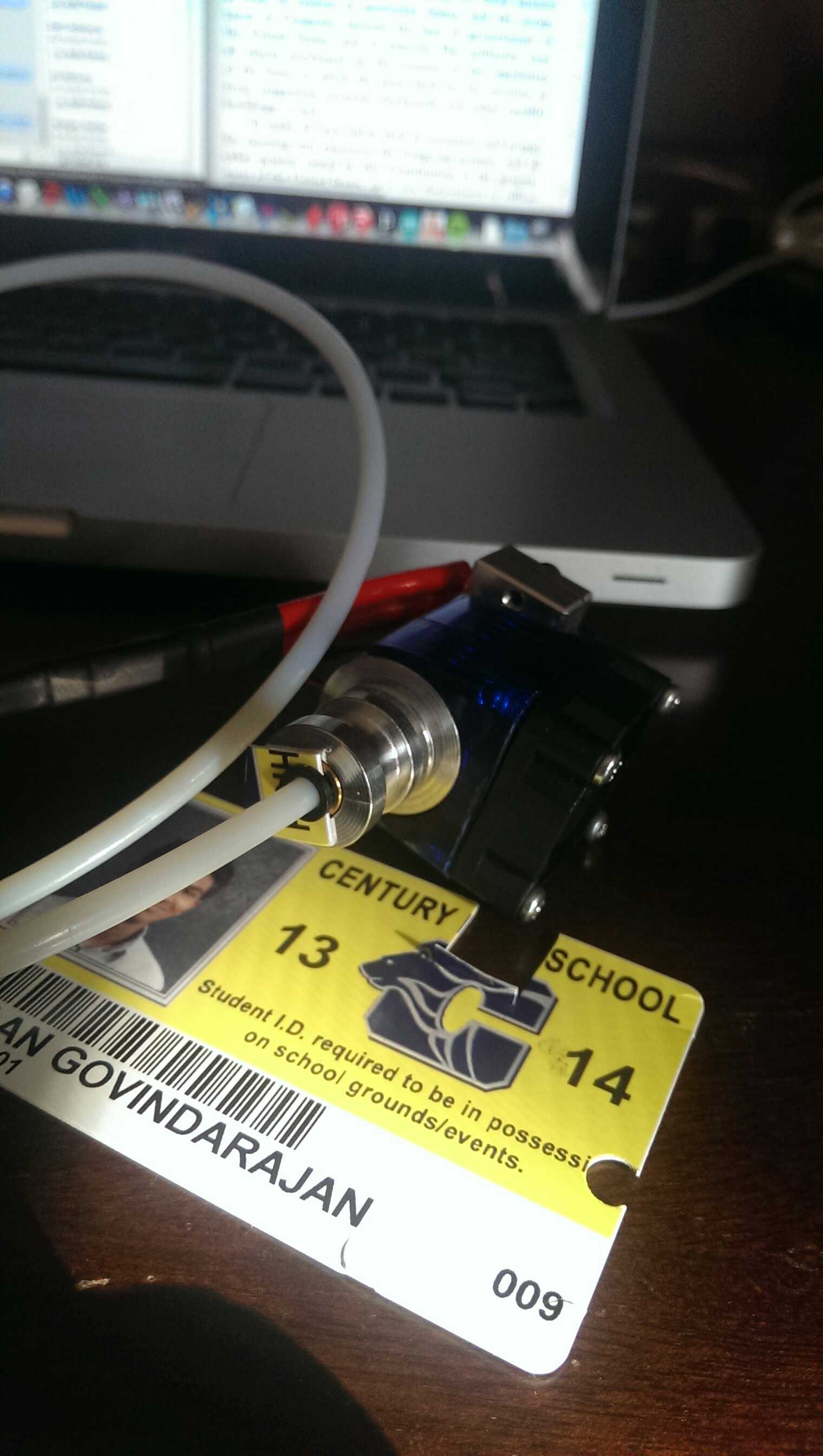

Quick tip for potentially better retracts on Bowden E3D v6’s (haven’t actually tested): hole-punch the edge of an old plastic card (credit card, I’D, etc) and cut out the shape for an Ultimaker-style Bowden clip, which reduces some of the backlash during extruder retractions
I printed some of these from thingiverse. They work great.
Thanks @Ishaan_Gov , this is a great idea!

How are you liking the extruder? I’m thinking about one
@Andre_Mercado , I haven’t actually finished assembling my printer; I got it because almost everyone recommended it. Hope it helps :slight_smile:
Good idea. Thanks!
