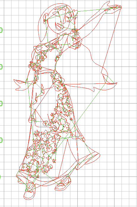

When I generate from an SVG, I expect the laser paths to just etch paths which are in the SVG, but instead I get a whole bunch of extra lines.
Background: I have a 500 mW laser (on Creality Ender 5) and I’m just trying to etch some stuff into wood, not actually cut. but “laser cut” seems like the closest option in generation mode. I don’t know if this is the source of the problem?
This problem has always happened (but I’m new to laserweb and laser etching in general).
Steps to reproduce
Notice how there are a bunch of straight join lines with laser on which don’t correspond to paths in the original SVG. Are these supposed to be there? Is this a bug or some misunderstanding on my part about what LaserWeb is supposed to do in this situation?
I notice those straight lines you’re talking about are a different color… is there a setting to show/not-show the “moves” of the laser head. ie these might just be the movement to reposition the laser head for the next section.
Ah! it’s already in that mode I think. The red lines are definitely “laser on” (I have also verified by printing). greens are laser off, just showing the gcode movements. I’d expect the straight red lines to also be green (ie Laserweb should be saying "OK I’ve finished this path and need to move to somewhere else – I’m gonna turn the laser off for that bit – as it does for the green cases)
Looks like bug.

@dougl yes, you are right. Green are travel (high speed) moves, Red is the ‘default tool active’.
There are other colours for other tools, this is a CNC thing; not all firmwares support the T flag for tool selection, but this is for those that do.

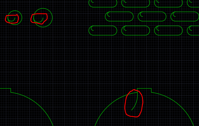

@easytarget ,
I noticed the same thing for basic R12 DXFs polyline paths. I am super careful to leave the polyline paths open, but still the GCode looks like what @strangefeatures is experiencing. It sounds there’s a tendency for the path processing to force-close some of the paths. I fiddled around the mergepaths function (actually created a dontmergepaths to preserve vertex sequence and perform piercing) but I haven’t dug yet where the force-closing is happening. In my case it’s lesser of an issue as I’m aiming for cutting through and the force-close is happening within the part to be removed.
I have to try this again with your fork and DXF2000 to see if there’s any change in behavior.

Ok I have done some high level testing here. It was a bit of an undertaking because of npm versioning. I have a feeling that the old importer was the one messing the path lines.
Here’s a snapshot of my original document. The paths are not closed.
With the original importer I get this in LW4 4.0.999:
Somehow the old original importer is trying to close those open paths with a line or an arc, but not always. The GCode hasn’t been generated yet.
With the @easytarget version:
The paths are not forced-closed anymore.
Of course when generating the GCode I’d get red lines (laser On for G1 moves) and green ones (laser off for G0 moves)
