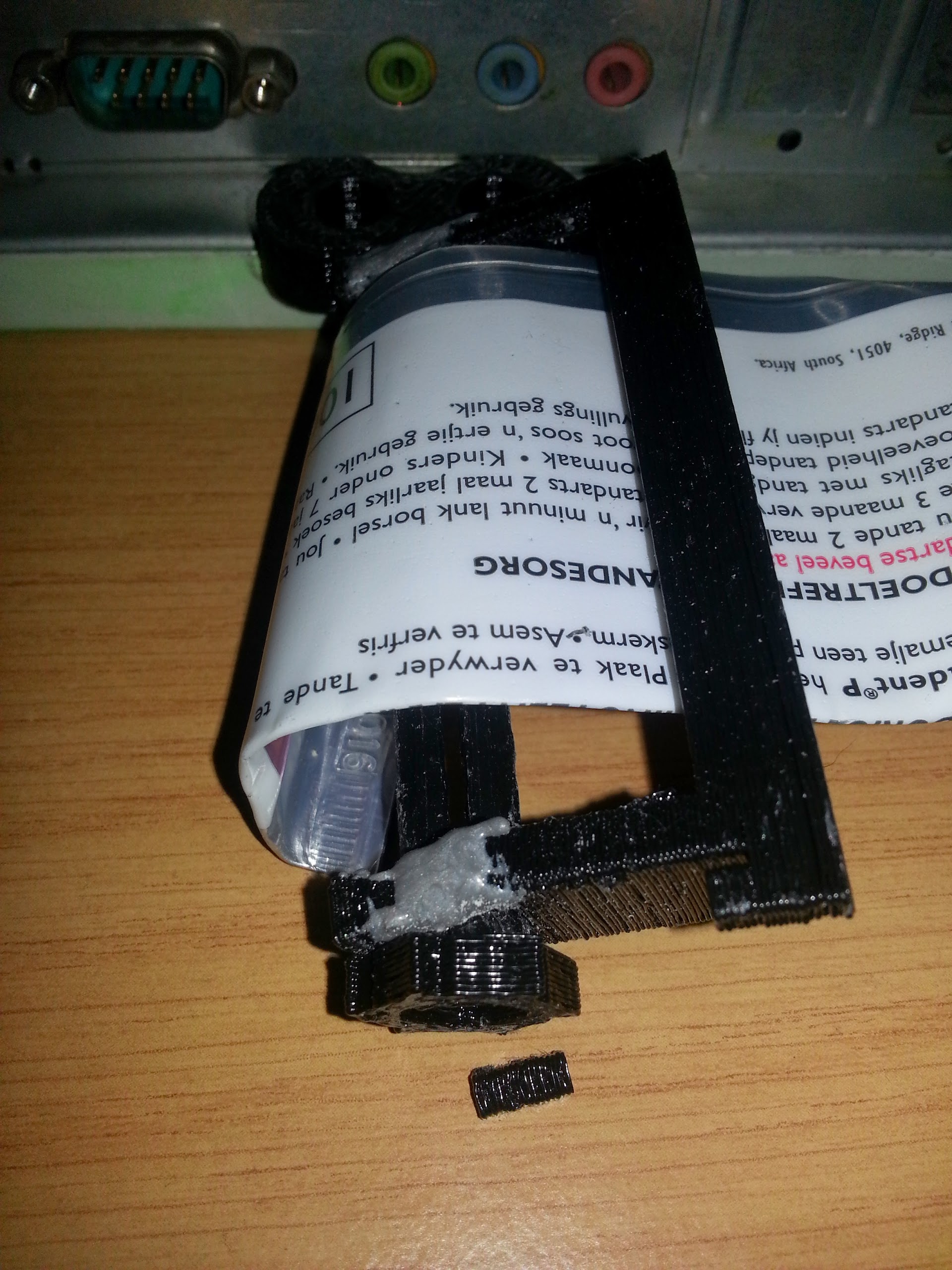

Why are my PLA parts so flimsy :( I printed these cranks for that
Why are my PLA parts so flimsy :frowning:
I printed these cranks for that parametric music box thingi,
but their one arm keep on snapping off when I put it over the pulley.
Eventually I re-inforced it heavily and heated it with a lighter before I could get it on. Previously I didn’t have an issue when I printed it scaled to 90% . But I noticed that a lot of my parts break very easily like this toothpaste roller, I had to glue it back together :frowning: . Are the designs on thingiverse that bad or do I have a slic3r setting problem?

Layer height too high? Layer height should always be <80% of nozzle width. Also, yes too strong of a fan will cool the PLA too quickly.
@ThantiK yeah I tried it at 0.2mm and 0.4mm layer height (0.5 nozzle) both snapped :frowning: thx
Whats your infill % ? Which printer are you using ? And where did you buy the PLA ?
@Shachar_Weis the issues are on solid infil, and it looks solid and if I increase the width there is too much plastic, though i can look at that again. Infil was 0.12 to 0.15 . Printrbot. I also notice that it is not hard enough to pull off a solid appendage from a flat surfice. The pla was sourced from http://openhardware.co.za who imports from somewhere, their have a good reputation among my 3dprint buddies. Thx.

Got it working now at 185 degrees C, thanks to +Peter van der Walt from http://openhardware.co.za who told me that higher temperature makes the PLA a bit more brittle.
