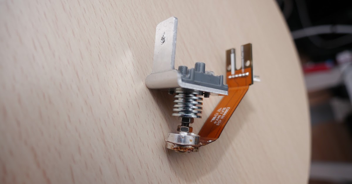

The barrel is metal and screwed into the hot zone.
Aparently the same problem as the Thing-o-Matic hotend had, except it’s thinner, so I can’t easily add heat-spreaders and fans. (On the ToM I added cicular heat spreaders and 2 fans. Since the battel is inside a square space the fans managed to make the air move downward instead of passing hot air upwards in addition to the heat transmission in the metal itself. It did help quite a lot.)
These new all-metal hotends like the E3D seem to include cooling fins and a fan on the upper part of that same barrel.
I’ll try to emulate that using very small and very large washers. I’ll also move my fan down to blow across these.
Maybe a paper-washer between the heater block and the nut on top of it could help too.
I’ve seen people use nuts and large washers to emulate e3d, don’t know how well it works…

I did my experiment with the washers
and it FAILED.
So I guess I can skip any machining of a heat sink. This doesn’t solve my problems.
