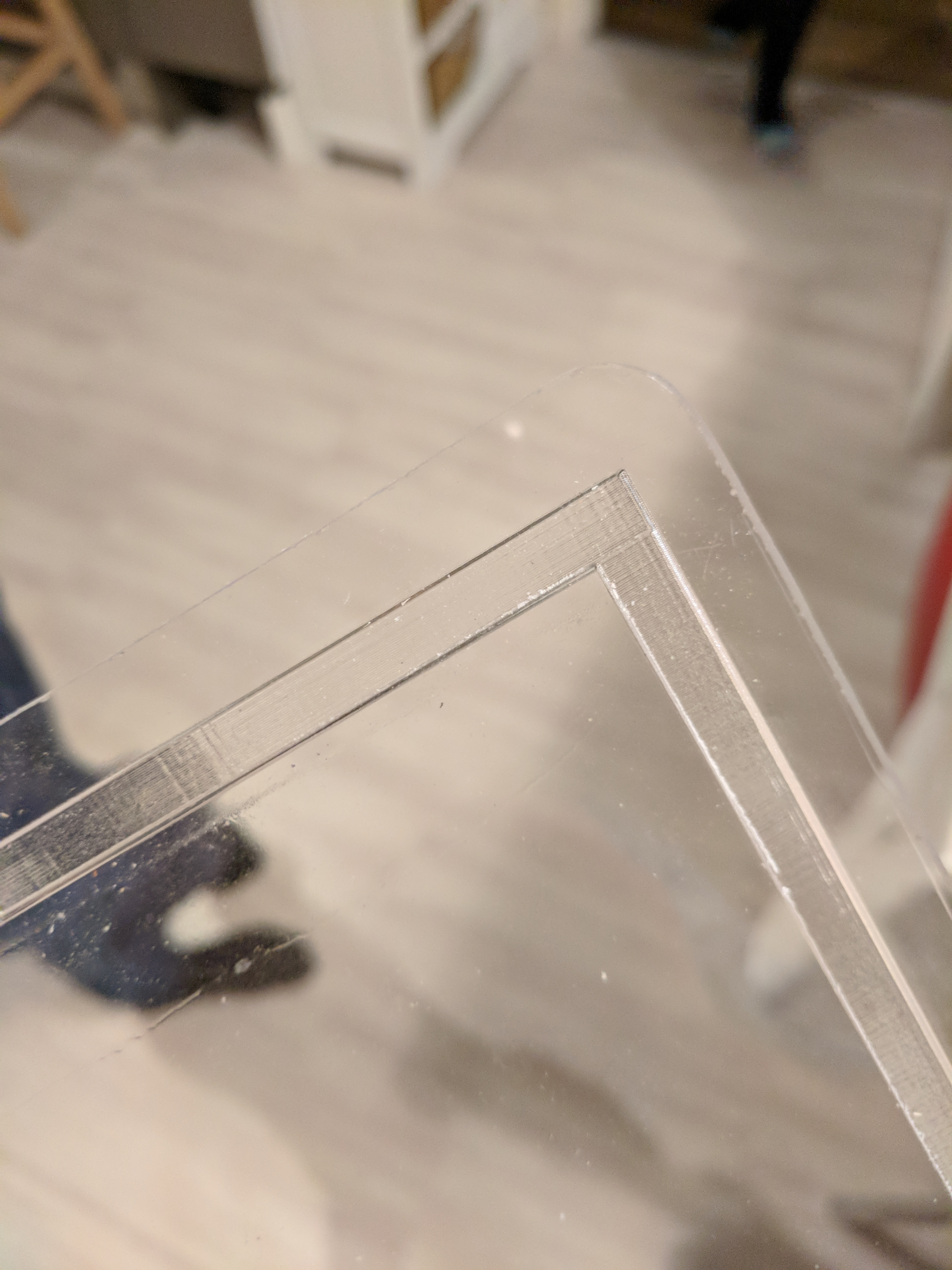

6mm acrylic cut at 15mAh 350mm/m in 2 passes.
Engraved square cut out @ 10mAh 3500mm/m and then joined it all together with making tape followed by ema plastic weld solvent. I just need to mastic the inside to get it completely air tight then the fun can begin.
Nice. What is it for?
It’s a vacuum chamber, connect it up to an old fridge compressor and it will suck all the air out and give some fun results with what you put inside. Check out you tube the are loads of videos.
My son and I like to make so fun things every so often and this was the latest idea :wink:
