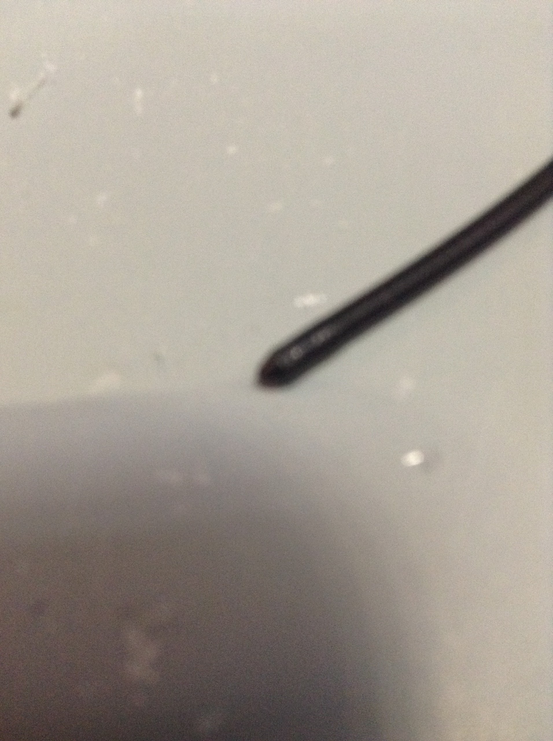

Why does this happen? Print randomly jams and i have to cut off the end of the filament and restart the print. The end of the filament is a little bigger than it should be when it gets jammed… What fixes that?

The end is always a little bigger for me when I pull it out. There’s always a part I have to snip off so it loads nicely next time.

What is this? ?? Photograph. …
Its a tip of the plastic when pulled from an extruder
