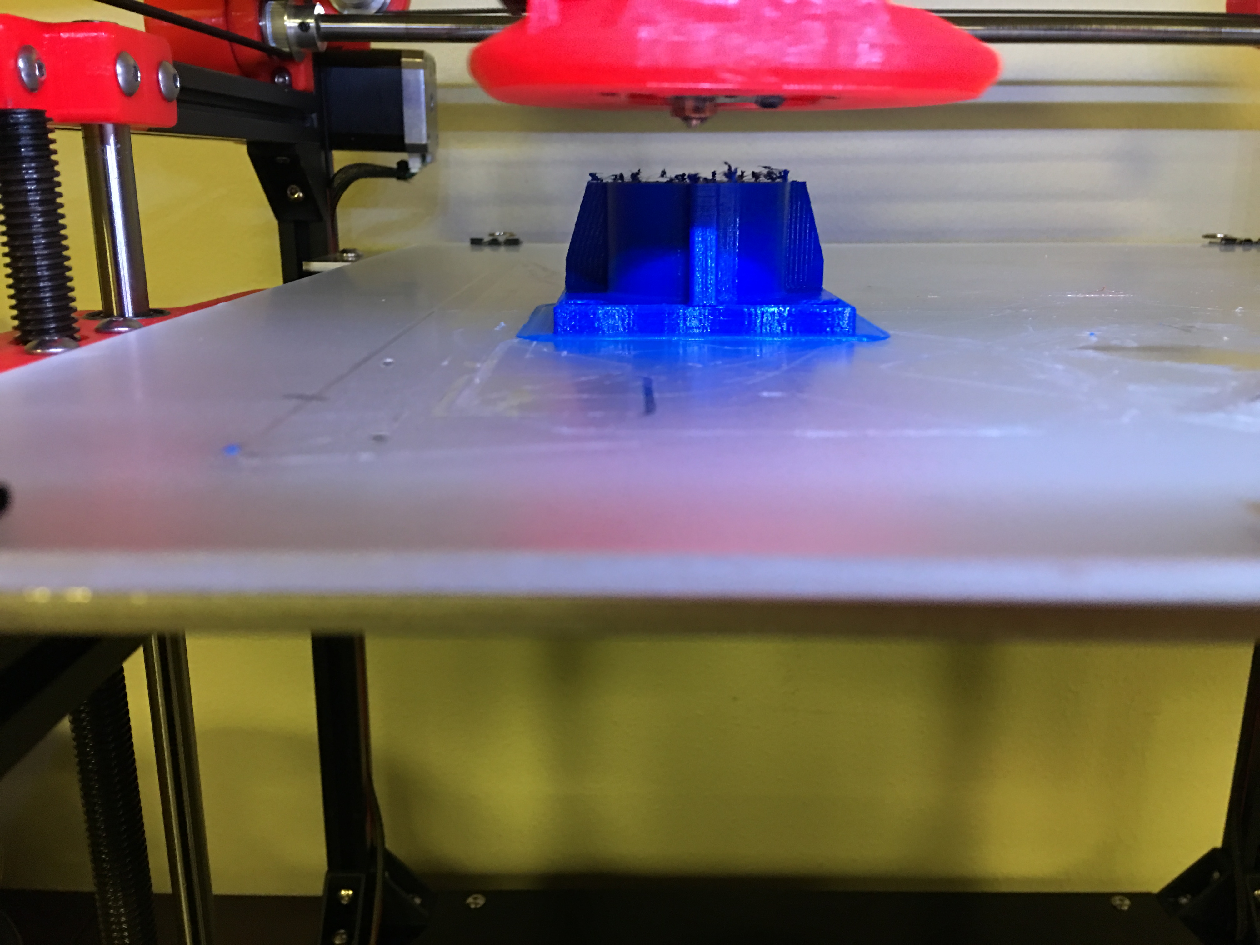

Why does this keep happening? Mid print, it just stops printing and I can’t push any filament in through the hotend. The hotend shows that it’s 230 some degrees for Hatchbox PLA.

I lowered the retraction to 4mm and changed the retraction speed to 40mm/s. I have the temp set to 230 but while it’s printing, the temp is currently 225ish. Watching the temperature curve in Repetier Host, I don’t see the temperature dropping down below 220. It ranges from 223 to 230.
When it jams, I pull the filament out of the hotend and cut a piece of it off. After that I put it back together and push some filament through.
