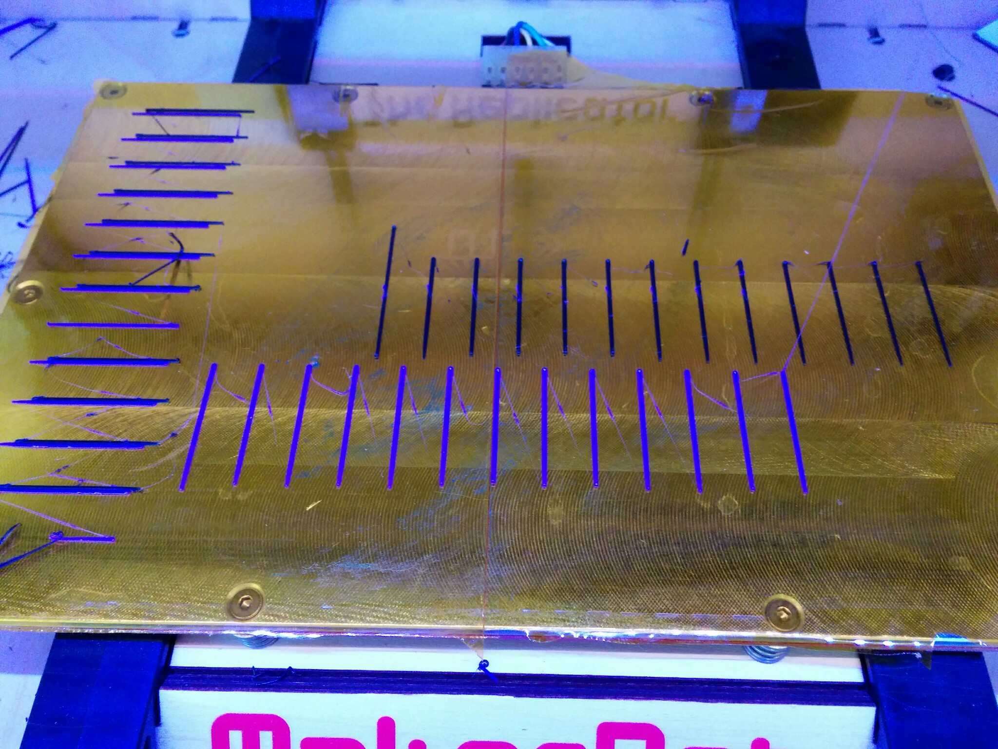

Why is my makerbot dual doing this during calibration?
Why is my makerbot dual doing this during calibration? How can y be so far out?

Looks like what happens when the extruders are wired in reverse, so extruder 1 is connected where extruder 2 is supposed to be, and vice versa.

@joseph_barrows I don’t remember exactly what the setting is called, but the Firmware contains a setting for the nozzle offset. If it’s too far off, you see things like this.
Stock 7.5 firmware
I too thought the extruders were reversed so swapped the plugs on the mainboard, but that caused the feed motors to run backwards somehow.
Is the last of their open devices, are the instructions on how the physically swap the extruders?
Kenneth, This is the output from the firmware nozzel offset utility, set to middle of its range.
