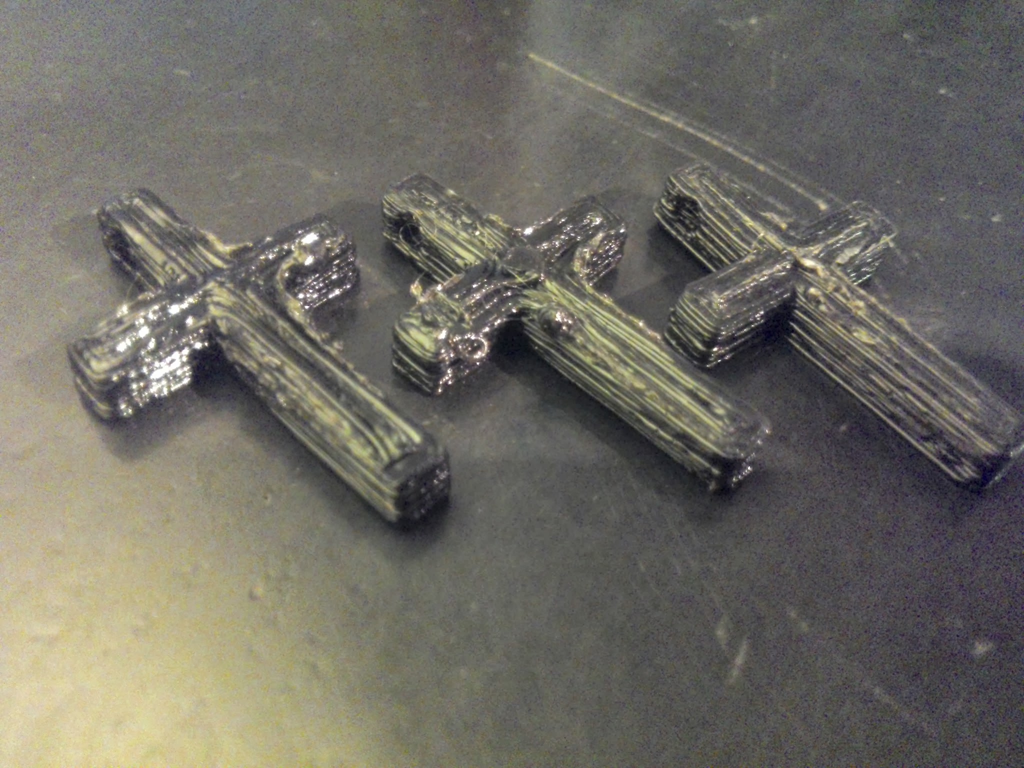

Why is this happening?? :/ bought the E3D extruder,
Why is this happening?? :confused: bought the E3D extruder, and after I started using it it seems like too much filament is coming out… Which setting should I adjust ?
E steps/mm (firmware), nozzle size (slicer), filament diameter (slicer) (trust me, measure it!).

I’m a noob, but once I got that tip, I measured and found my average (pretty consistent) diameter to be 1.85mm; about 5% greater than advertised! BTW: Also check along different diameters at same point to determine roundness (mine is good, but I hear some are more oval).
At the end of the day, if the filament maintains a consistent diameter and roundness, even if it is not perfectly round and is significantly off the nominal diameter, you should be able to get a decent print after you tweak your numbers.
Out-of-roundness tends to maintain their orientation, so as long as your filament feedpath does not allow the filament to twist around, the drive gear will tend to engage consistently.
This assumes, of course, that the diameter and roundness is reasonable - not so extreme that it can’t feed the material.
Now, that said, if you do have a bad roll where the diameter is all over the place, or the roundness fluctuates, it’ll turn out poorly.

Is the density of that material the same as before you printed it out? There is a “packing density” referred to by some of the slicer software out there. You might want to consider accounting for that.
I can’t claim to be a pro at this. Some of my prints are still a little off. I think I have interference between nearby wires on my delta printer. I figured my simple input would be useful though and so I brought up this possible cause nobody else mentioned.
@NathanielStenzel I did not find that setting… but thanks anyway!
They might call it flow ratio.
