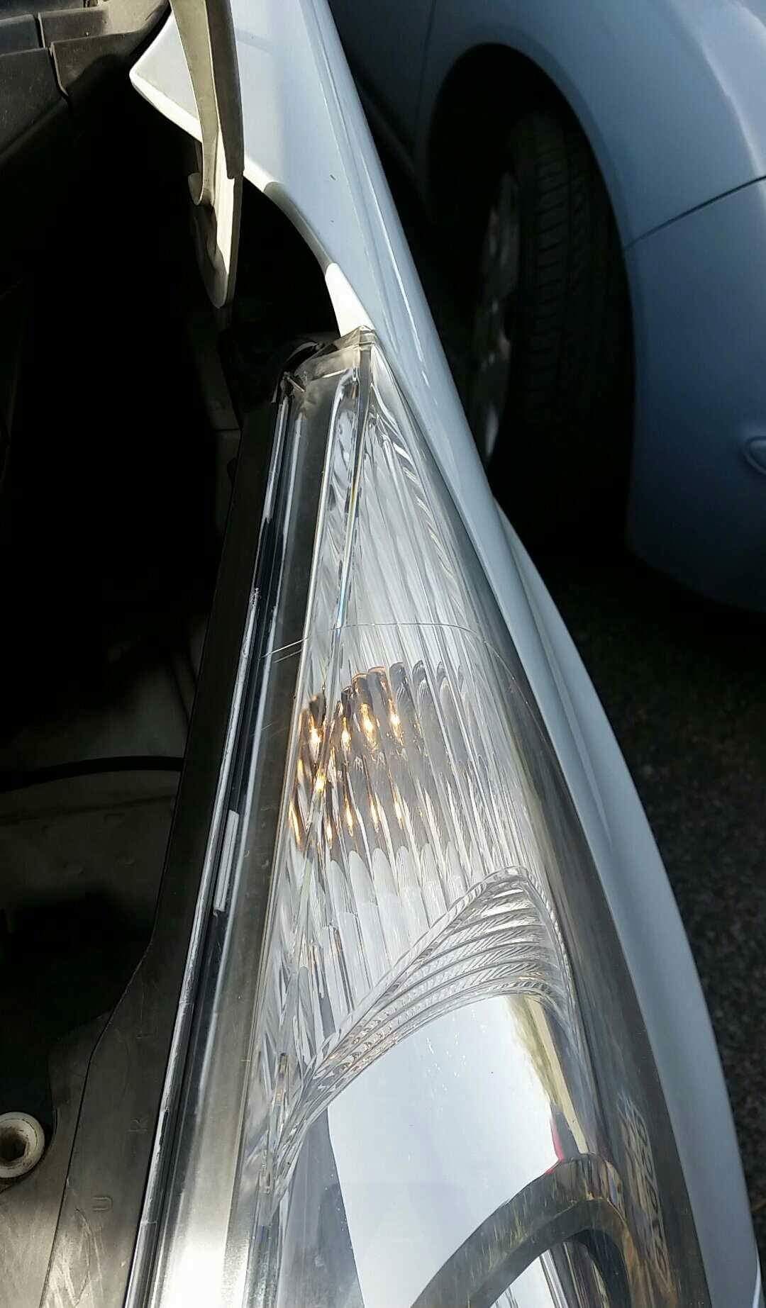

why love digital fabrication and 3d printing…because can change rules. Little story… i for my distraction i lose one piece of my car.
phone to my brand car and this confirm this item sell and need min 5day and 50euro(used highlamp avrange 160euro). OK i need it ASAP because generaly drive in during night or early morning.
At work no have caliper and use my phone for take measure and design on ONSHAPE a compatible piece. after work go in fablab and without thinking 2 time print it. use old floppy 1.4mb (with metal cover) for make socket T10 .
Result ? an issue on one measure but i correct it with knife and less of 3h I resolve my issue. (is print in z-petg and this type of lamp no heating more of 55°) Thinking in big car company can give better services with 3d printing.
