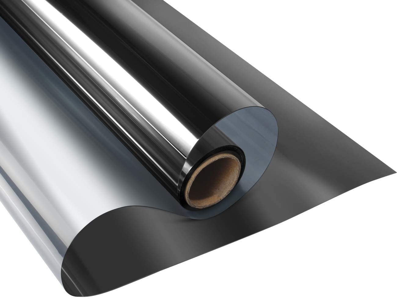

A lot of what I’m finding is mirrored sputtered-metal film, like this:
I guess if I mount enough LEDs inside the case that would be OK. But I’m going to keep looking for non-mirrored film options. Here’s a 2 mil PET sheet that has a datasheet available. It has 99% UV blocking and 83% transmittance, and low (less than 4%) reflectance:
It looks like there are lots of brands of UV-blocking PET film. This seems like a good route, and I don’t have to decide right away.
