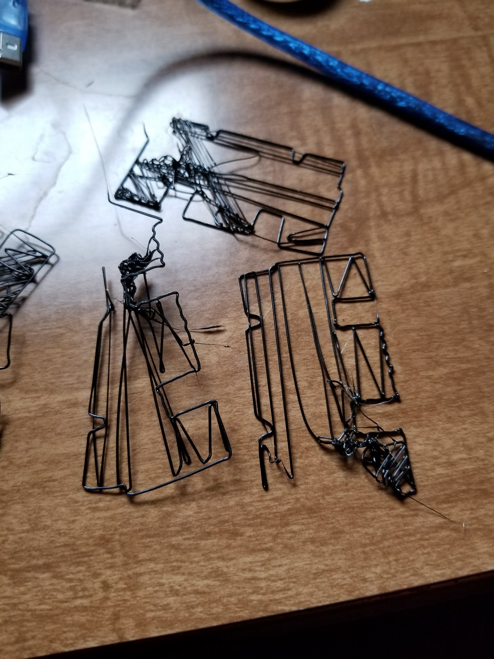

Why would my base layers be messed up like this.
Why would my base layers be messed up like this. I am very new to printing. My first piece I did looked good and no problems. I bought some new filament it is PLA black from monoprice where I got my printer. No way to start printing if the base sucks.
It looks like your hot end is too high.
Hot wnd to hot and nozzle not close enough to the bed. Google bed leveling and you should find your answer.
Also what are you using on your print bed? Tape, glue, slurry? Is that abs, pla or other?
Don’t get discouraged. Just make sure your bed is properly leveled. As the other comments point out, it looks like the nozzle is too high. Take a piece of standard copy paper and adjust the platform until the paper can slide between the nozzle and the bed with some resistance. Also, using blue tape or a glue stick also helps.
Thanks for the help I think I figured it out. I had bought the new filament so I went back to monoprice to see what it said. I got PLA it said a printing temp of 210c. I was only at 195c so I upped the temp and it printed great I think. I did go back and level the bed again. How much space should the be between hot head and the heated bed? I got a filler gauge so I can get it right. I may have to use something other than the mat it came with for my bed. Got it as close as I can but the is no adjustment left to get closer so I may try tape.
