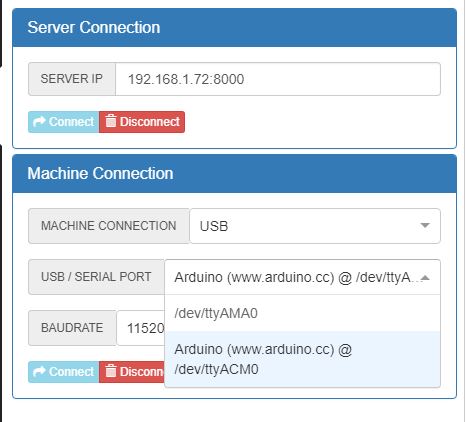

Hi,
I see the following on the laser web exe frontend when I boot it up.
Serial Port
Marlin Version
I’ve managed to fix the RE_NA problem on the Marlin version through updating the Version.h file. Sadly, the laser test function still doesn’t work as expected. However for the time being I have worked around it by adding a macro which does the same thing through M3, G4 and M5 GCODE. I guess that will do. My bigger issue now is fixing the quality of my jobs but I will open another thread for that. I think the original question has already been solved as it is possible to run lw-server on a buster 3B+ but I will still be buying a 3B to load Jessie so that I can test to see if these problems are caused by the distro.
