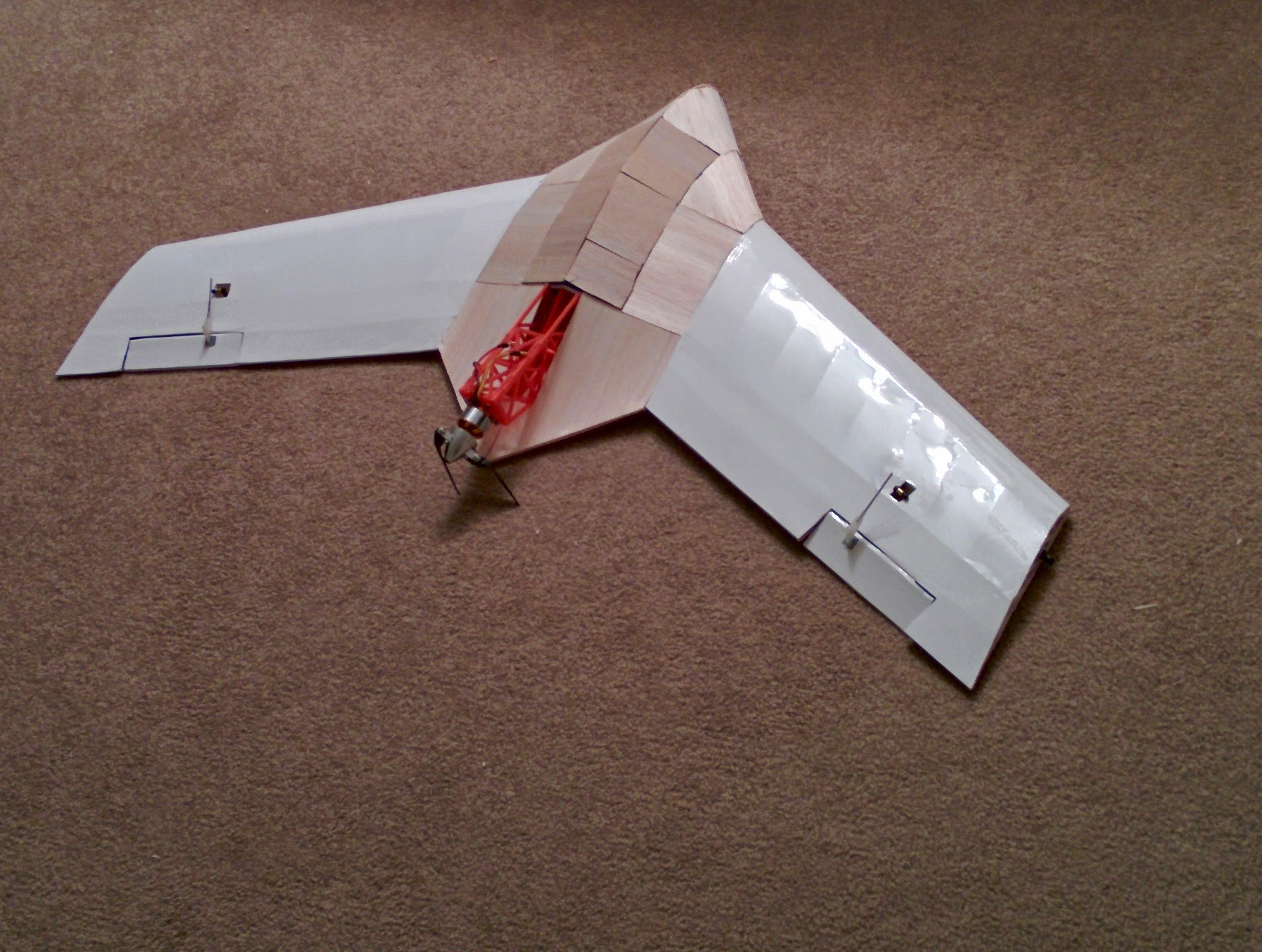

Wings are covered, belly was fibreglassed.  Technically, if I wanted to,
Wings are covered, belly was fibreglassed. Technically, if I wanted to, I could attempt a flight at this stage. But I think I’ll take my time and finish her covering first. I have to figure out a color scheme.

Don’t you need some vertical surface?
Nope: Check out this picture: http://rtfmaero.files.wordpress.com/2010/05/horten-new_pul-10-2.jpg
I suspect that the wing sweep has a stabilising yaw effect much like wing dihedral has a stabilising roll effect.

@Andre_Roy You maybe right, but I have a feeling it will still be quite unstable. I seem to remember reading about a flying wing using split ailerons to provide dynamic yaw stability to avoid any vertical surface.
Also, I have a flying wing RC glider that has little vertical surfaces on each wing held on by tape. When one falls off it becomes very unstable.
Having just looked up http://en.wikipedia.org/wiki/Flying_wing It does look like yaw stability can be achieved with the correct wing shape.
Thanks for sharing your build, and I am looking forward to seeing how it flies.
@Philip_Stubbs_stuphi , Your destab might’ve been due to the change of drag on one side when you lost a winglet. I’m planning on adding flat plate winglets like you describe, but not for reasons of yaw stability.
They are generally used to reduce lift-induced drag by preventing wing tip vortices: http://www.grc.nasa.gov/WWW/k-12/airplane/winglets.html
You’re welcome, I might not have seen the design through to the end without motivation from @Brook_Drumm and also you guys. Fun discussion.
@Brook_Drumm , regarding the skinning method, is the fibreglass step turning you off? That’s kind of an advanced skill I admit. But it’s not as bad as you’d think, for example the epoxy resin I use doesn’t smell. The balsa skinning should be accessible to anyone.
The plane needs a hard shell belly to take the impact of landing. We should brainstorm ways of getting rid of my fiberglassing step. Perhaps we can add a landing skid of some kind. I should be able to make that out of PLA. I’ll think about how best to do this.
