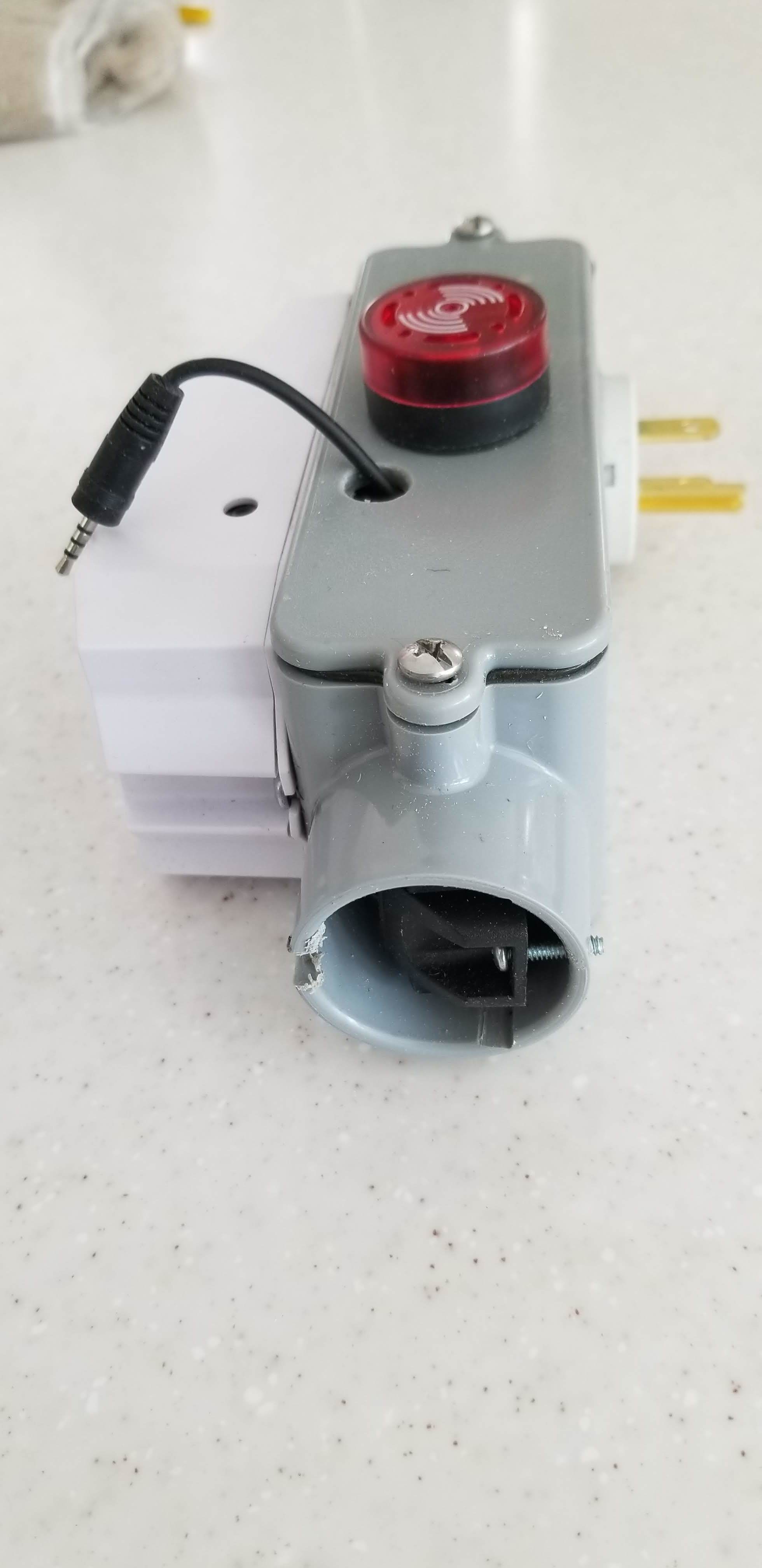

I currently use a aquarium heater/controller and leave the pump running. It has a tethered remote digital readout and is self controlled.
I plan to add the use of a Sonoff TH10 WiFi Smart Plug with Waterproof Temperature Sensor Probe so that I can see and control the temp from my phone and Google Home.

I plan to use the below wifi controller to manage my water during the winter next year.
Its relay will be connected to an aquarium heater (which I use now) and the water pump.
I can monitor the control and temperature from its App (eWeLink) on my phone.
Update: their is an alternate waterproof sensor for this controller.
Remote wifi temperature and humidity alarm & control!
