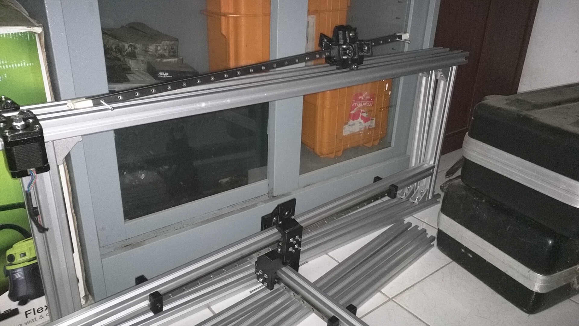

WIP Hybrid CNC Laser 3D printer Dimension 900x720x320mm Build area 640x580x260mm Slider Pla infill
Slider Pla infill 100%, 0.2mm
Linear motion guide 2 rail 4 block each axis THK RS12VM
Aluminum profile 3030 (12m)
X axis 1 stepper belt
Y axis 2 stepper belt
Z axis 1 stepper ballscrew
Any suggestion for board? Ramps or rumba?
Neither. Smoothie. Or the Replicape+Beagleboard.
Smoothie
Its really hard to find smoothie in my country :sob:
Robotseed.com
MKS SBASE
MKS SBASE has known issues with USB connections, as well as being a NON-OPEN source clone of the Smoothieboard, they ignore all the licensing provisions of the open source smoothieboard. They have basically stolen the design, and use the smoothie firmware developed by the original Smoothieboard developers.
