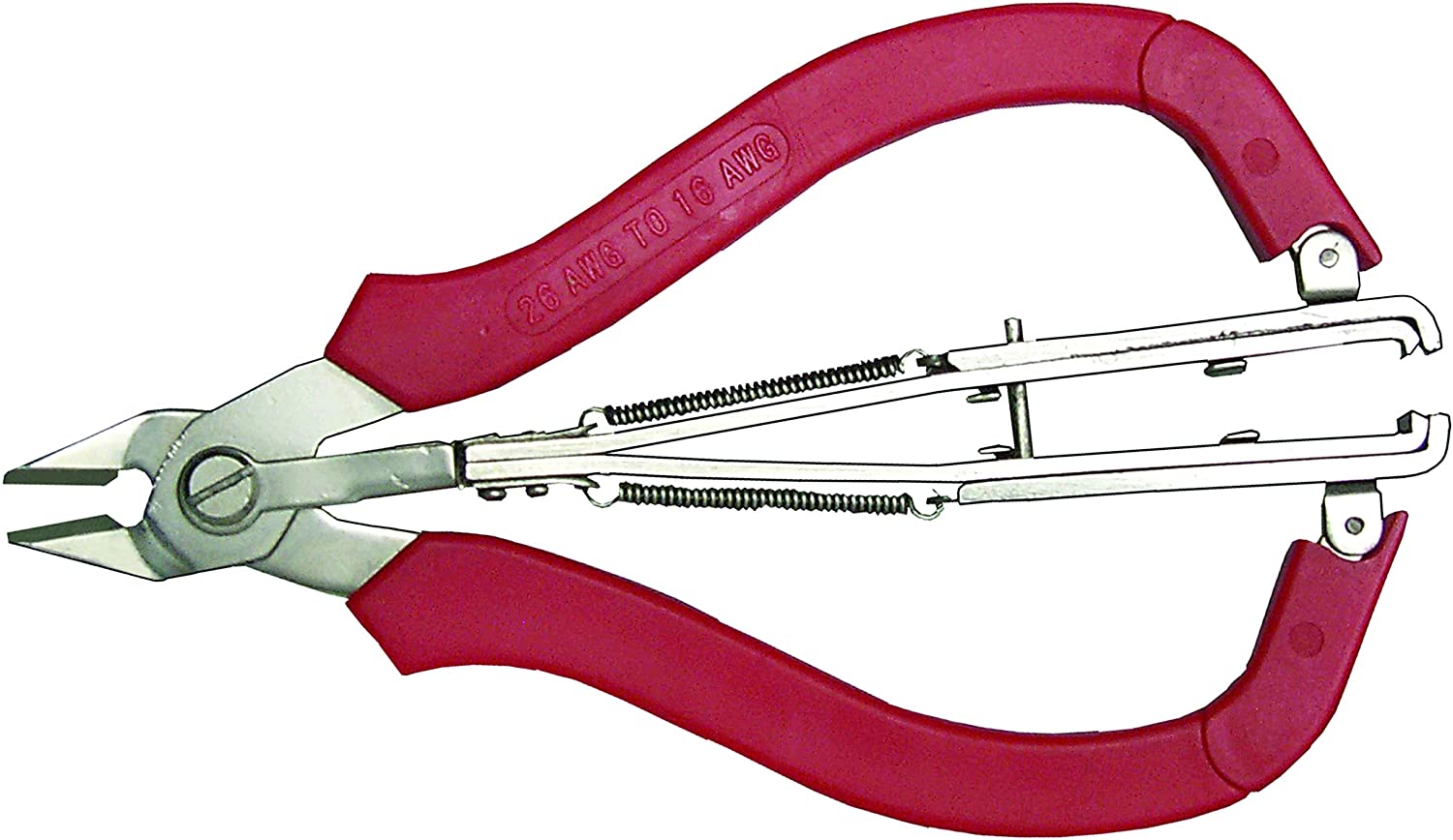

@donkjr I have tried the Klenk DA76070 and while I was able to cut and strip some wires nice and quick like the pliers are just too darn hard to close to be something I can use regularly. I really have to squeeze super hard before the hinges on the back reflex out of the way and let the cutter jaws close.
I tried putting some teflon grease on the sliding parts of the strippers but it seems to have had little effect on the drag of the cutting/retracting mechanism opposing the closing of the handle.
Were yours like this or did you do something to make the mechanism work more smoothly and with less force?
Mine are not hard to operate I can do it with two fingers of one hand.
The 2 springs determine the opening force maybe they are stronger than mine?
Must be something wrong with mine then. The problem is more like a locked knee joint than just the spring force. It takes lots of force to unlock the “knee joint” and then it’s pretty easy to manipulate.
