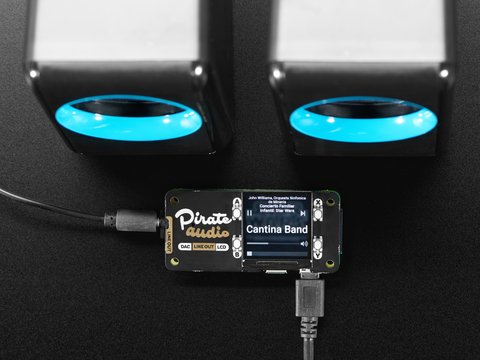

You should be able to use a raspberry pi zero 2 w with a Pimoroni Pirate board to do this.
I’ve used these with great success.
Those look so nice, I just ordered some for absolutely no good reason. :slight_smile:
