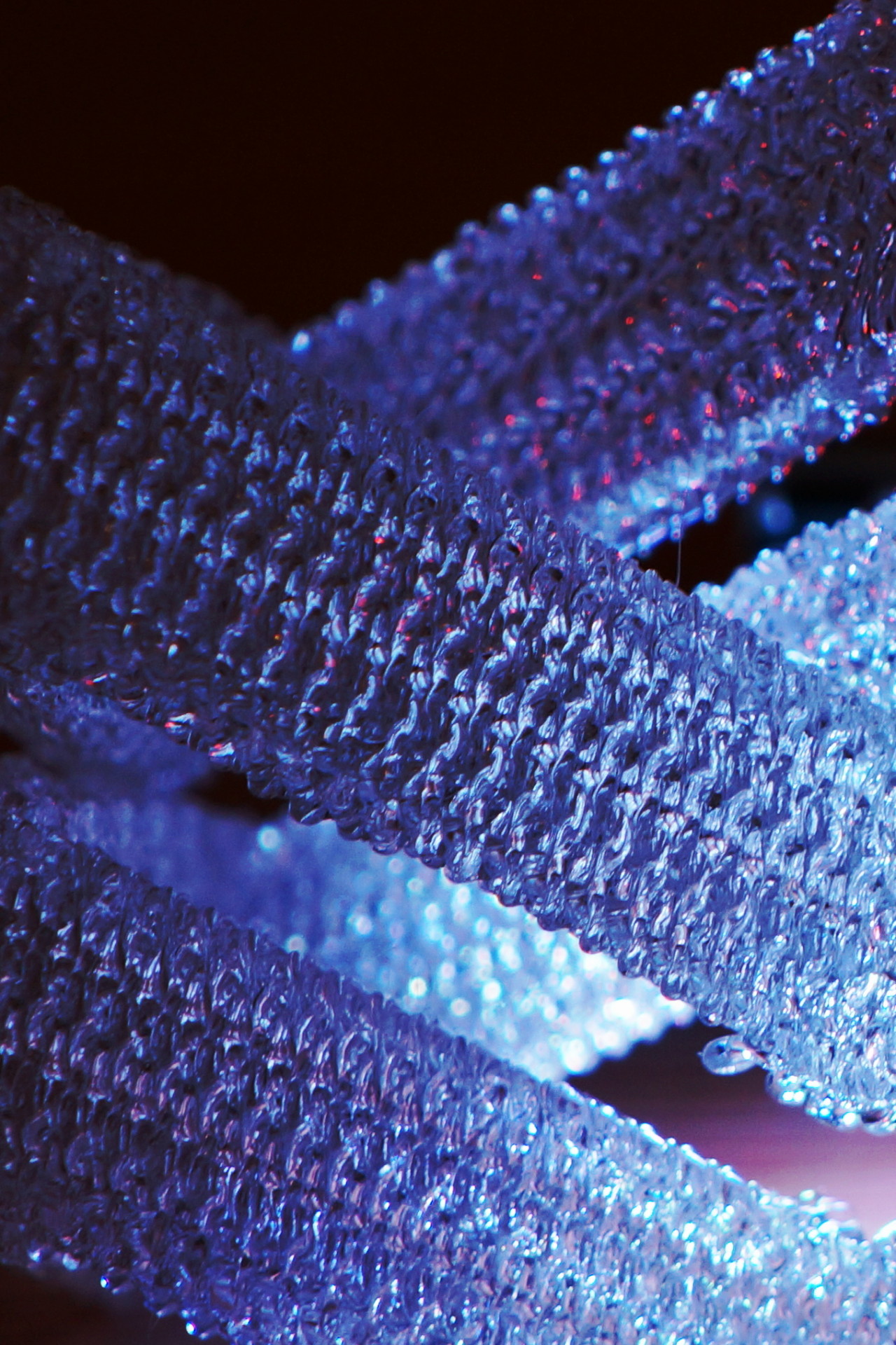

When i had to acknowledged that you can’t print a 3mm Part with rectangular corners using a 2mm Mesh - as this is just too coarse, i tried a 1mm Mesh and really like the outcome. This also limits the freedom of the extruded filament so you get a much more regular result. Like it is crocheted out of crystal glass. You also can print much faster as you don’t need to wait till the material deposits.

I find myself craving something to give scale – perhaps a lego brick in shot? These prints are small?
The Third picture you have it between my thumb and index… its 4.5cm high and the two beams are 10×3mm each in their cross section.
Put a match ontop hope that helps - the pattern itself is not that nice, but as the extrusion is now round you get nice optical properties.
Here a sphere (35mm∅) with BDP - so you can see the defects in the pattern.
