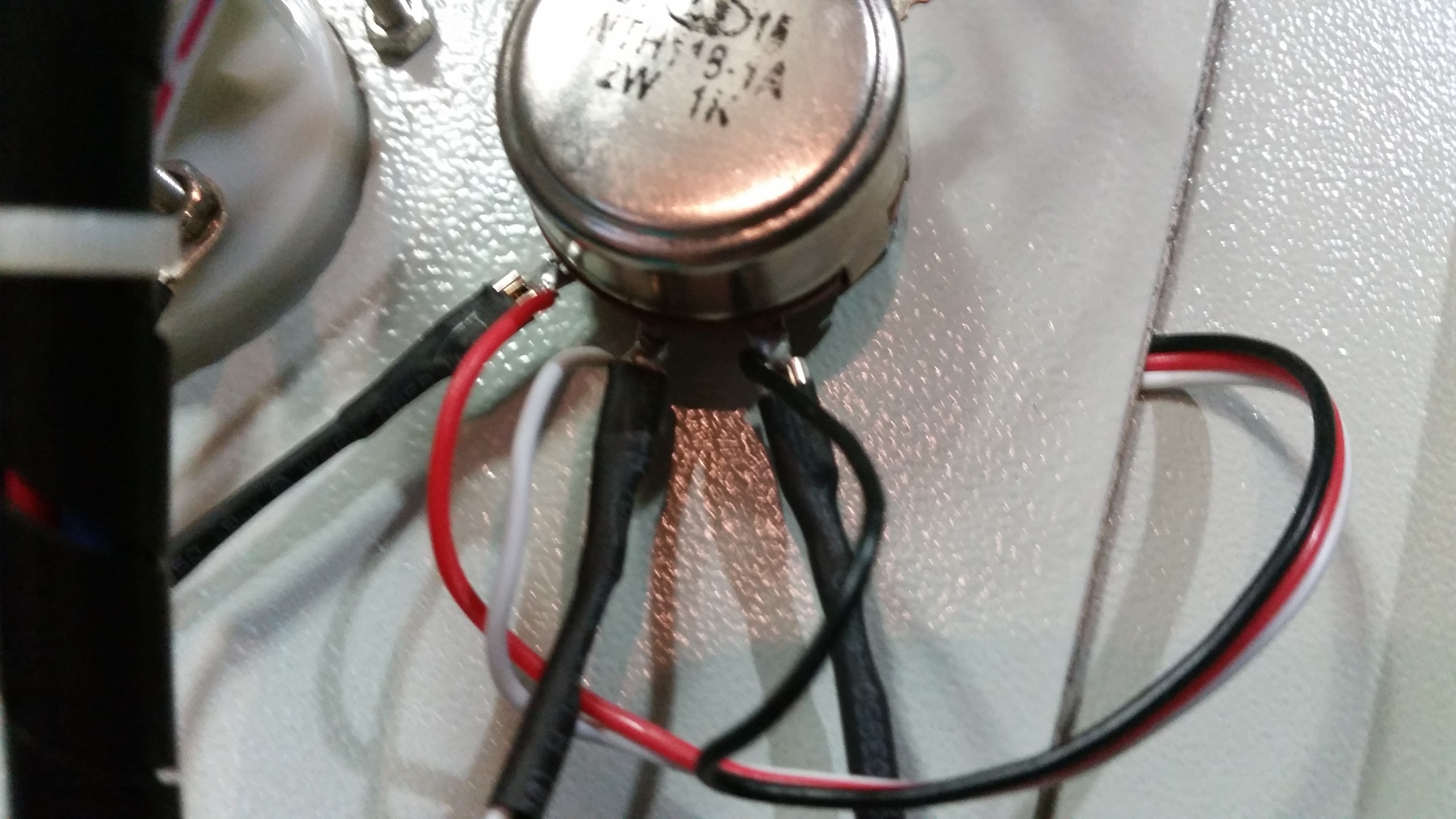

Wiring for the digital voltmeter on K40 current regulation pot.
Be careful which Voltmeter you get
@donkjr Voltmeter use 3 wire :
Red is Vin, Bleck is GND and White is Sensor.
Some voltmeter use 2 wire, VIN and Sensor being together.
The two wire versions are not good for one reason : there is a min voltage for it to work.
Let’s say the min voltage is 2.5V, then the Voltmeter will stay off until you set the pot to 2.5V which is 50% of the Laser power.
Using a 3 pin Voltmeter allow you to read the value even if it is 0.01V
