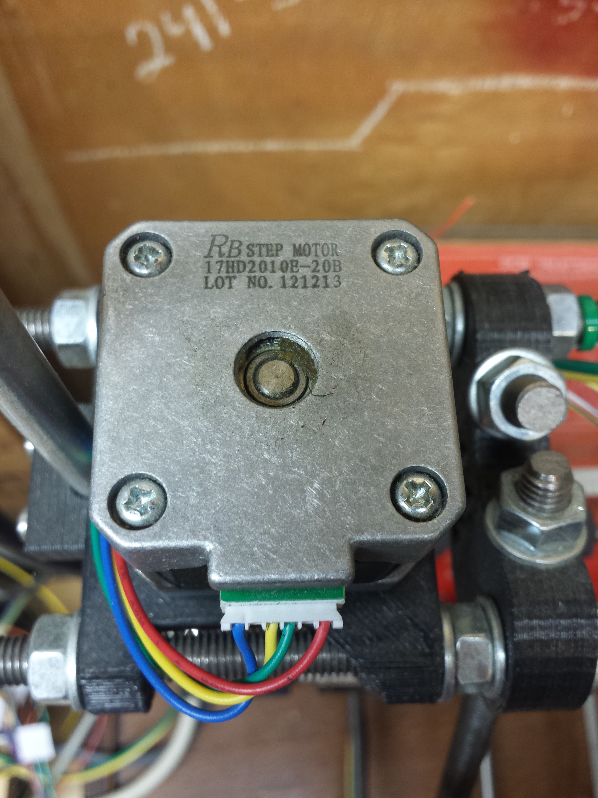

With my after x5 mini you can set the stepper current. Only problem is I can’t seem to find these motors on the internet. Anyone have any ideas what current I should set for these or a way to test for it

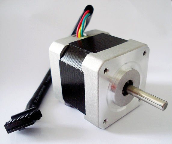

i think it is this one : http://www.kysanelectronics.com/Products/Detail.php?pageNum_rsIN=1&totalRows_rsIN=13&recordID=6453
@Benjamin_Engel It is integrated. Ill have to play with it i guess but I would really like to know the best to set it to.
@Sebastien_Mischler I cant seem to get your link to work
@Chad_Nuxoll ​ what board do you have?
Its an Azteeg x5 mini. Darn auto correct fixed it in the first comment to after lol
I just found this but 0.87A seems a little low to me.
Then bump it up to .9A
