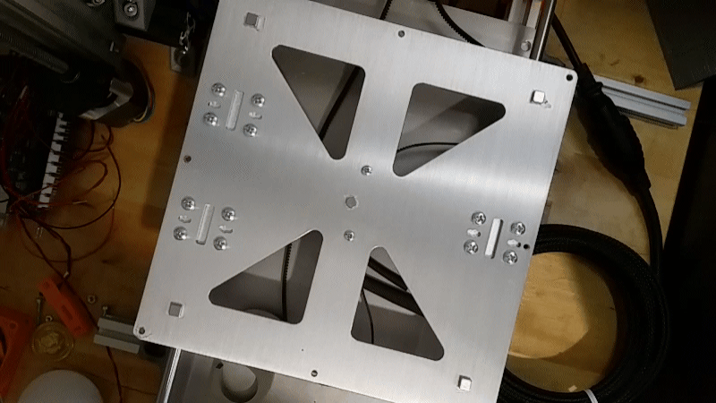

With strong magnet attached to the carrier and zebra plate.
With strong magnet attached to the carrier and zebra plate. Adhered with transfer tape just in case it didn’t work so I won’t have to destroy the dark side of the zebra plate. These transfer tape appear to hold the magnet very strong. Goodbye bull clip.
I’m going with no heated plate for now since I will only be printing PLA only so that first layer will be even more important to get just right. This zebra plate is flexible and will not be perfectly flat so I will be relying heavily on for mesh bed levelling and FSR sensor (finger crossed)
