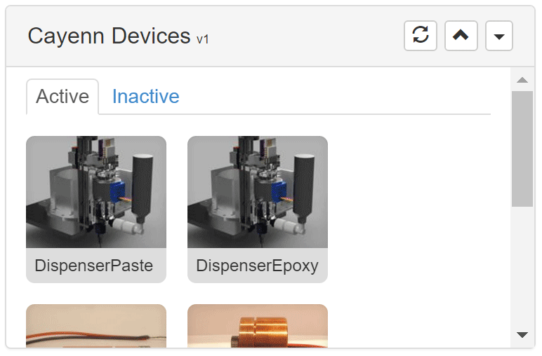

With the new Cayenn protocol, your add-on devices are new toolheads. The device announces which widget is the software UI. In that widget you can define a 3D object to represent the toolhead so it appears in the main 3D viewer. Here’s the concept for a dispenser. This is the preview of the 3D object for the dispenser inside the Cayenn control panel widget.
