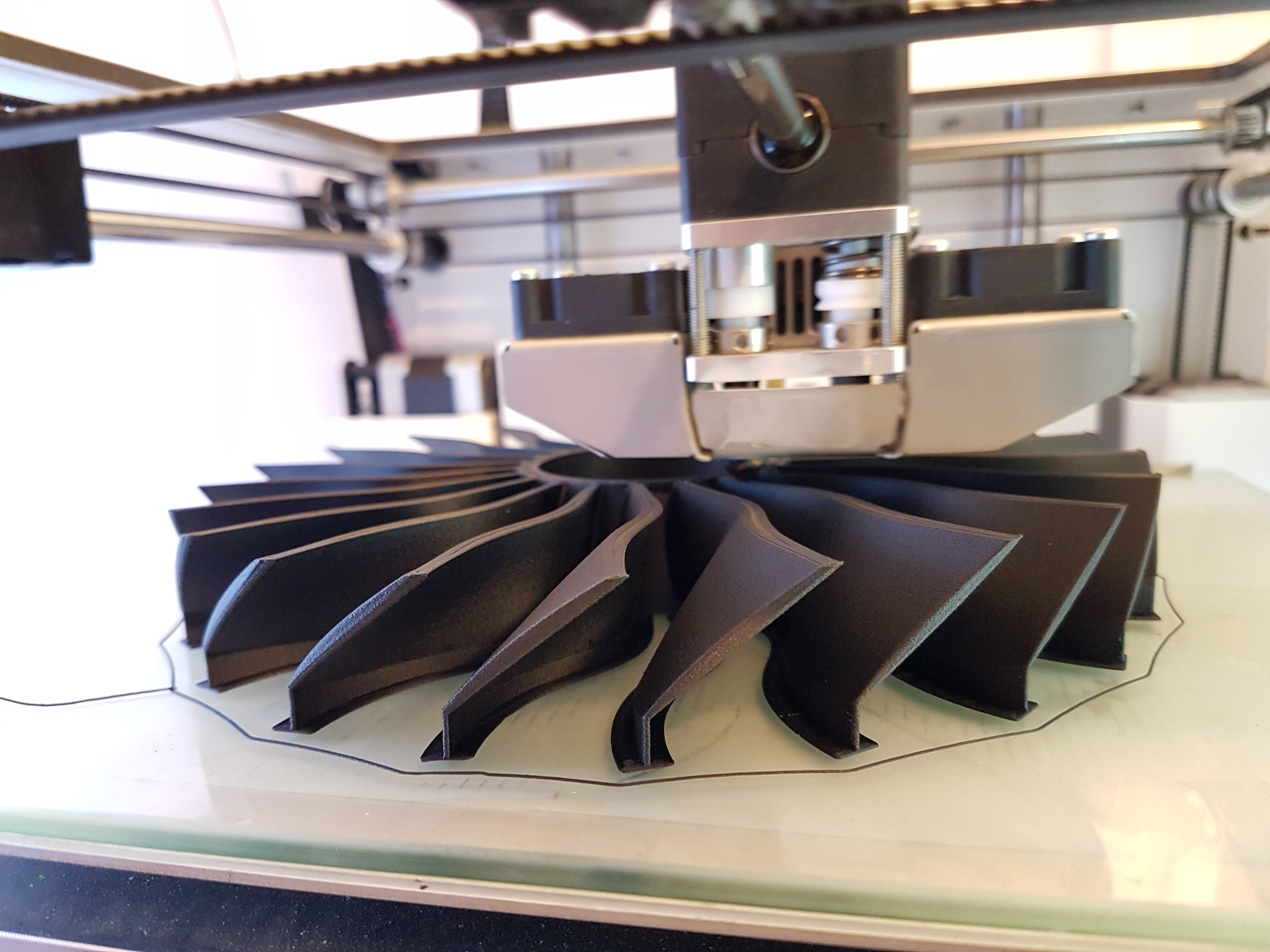

With the right settings, Colorfabb XT-CF20 does print pretty awesome! :smiley:

So which settings are you using?

What 3D model is that?

@Dan_Ghiciulescu , @Hakan_Evirgen and others, It is printed with Cura 2.4 Beta, sliced with the CPE “normal quality” preset and printed with no brim, 0.1mm layers, 245C temperature and pretty slow with a outer wall speed at 25mm/s and infill at 40mm/s, all using the new #OlssonRuby ruby tipped nozzle :slight_smile:
@Dan_danson_NavyMusta : It is Thingiverse model 1327093
